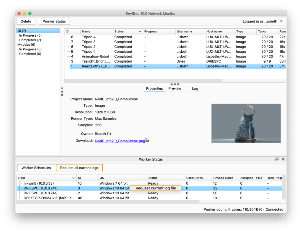

Access logs
Logs can be accessed via the monitor.
  • For all logs: Click the Request all current logs button
  • For logs from specific worker: Right-click the worker, you want logs from, and select Request current log file.
