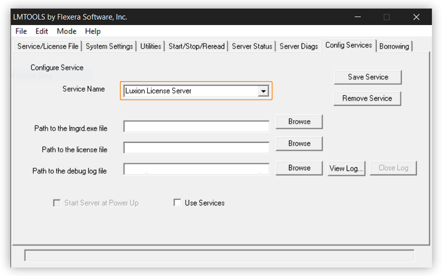

2. Launch the LMTools application (found inside C:\Program Files (x86)\Luxion License Server
) and go to the Config Services tab.
3. Write a new service name.
4. Browse to the lmgrd.exe, license (.lic), and debug.log files. You should be able to find all of these files in your C:\Program Files (x86)\Luxion License Server
folder. Note that the debug log is created after you start the service. For now, you can simply specify the correct path: C:\ProgramData\Luxion\License\LUXION.log
5. Enable Start Server at Power Up and Use Services. Then click Save Service and confirm.
