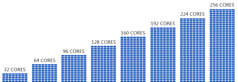

CPU Jobs
For CPU jobs, the correlation between render time and number of cores in your network is approximately linear and inversely proportional. In other words, by doubling the number of cores you potentially cut your render time in half.1
