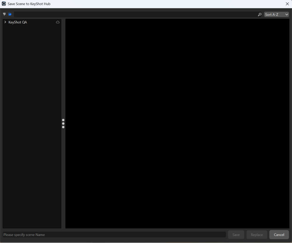

To upload a Scene to Hub go to File>Save As(Hub)... to open the save window.
The save window allows you to do the following:
  1. Save - Enter a Name in the Name field on the bottom of the Window and click Save. The Scene will be saved as a new Scene in the Hub.
  2. Replace - Click on any of the existing Scenes and click Replace. The Scene will be saved as a revision of the selected scene. Learn more about Replacing and Restoring.
Pop-up dialog; saving scene to KeyShot Hub
