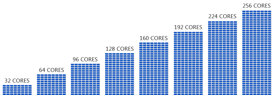

CPU Jobs
For CPU jobs, the correlation between render time and number of cores in your network is approximately linear and inversely proportional. In other words, by doubling the number of cores you potentially cut your render time in half.
The more cores you have, the faster your images and animations will render.1
Please note that render times are subject to hardware specs, core count, differences between workers, scene complexity, time scale, multi-tasking, and network traffic.
