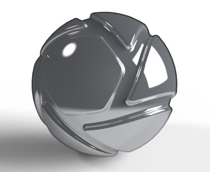

The contour texture will add an edge detail to your parts, similar to the Toon material, but applied to any material.
Advanced material with Contour used as a Diffuse texture.

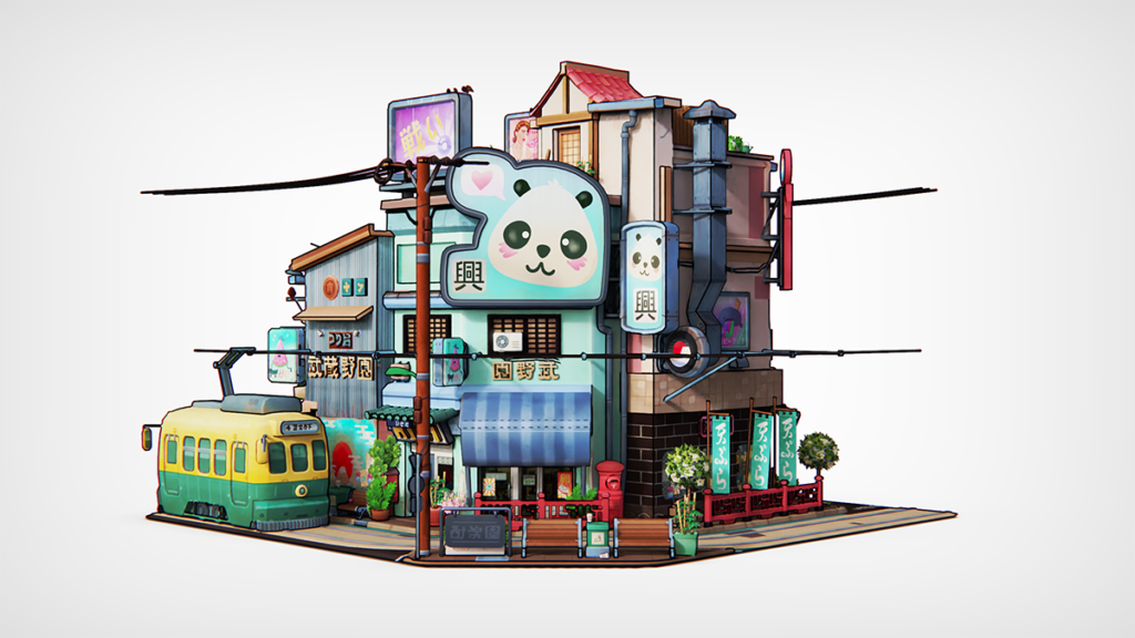

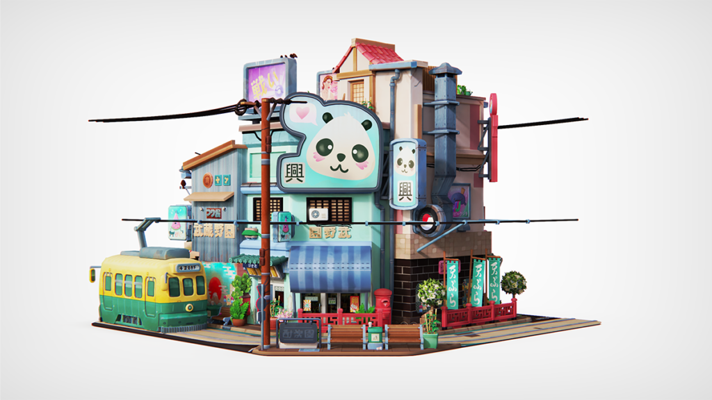

Same model without and with the contour texture. Model by Glen Fox.
Contour is a ray-traced texture. This means that the texture will start out coarse, but will progressively get more refined and smooth, depending on the texture settings and your machine’s performance.
