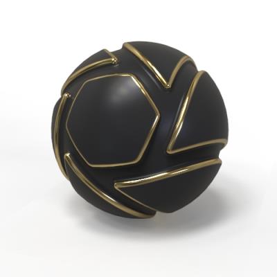

Use the Curvature procedural texture to analyze surface curvature in your model and parts or as opacity maps to create materials with worn edges etc.
In this example the Curvature texture is applied as an opacity map on a metal label on top of a black plastic.
