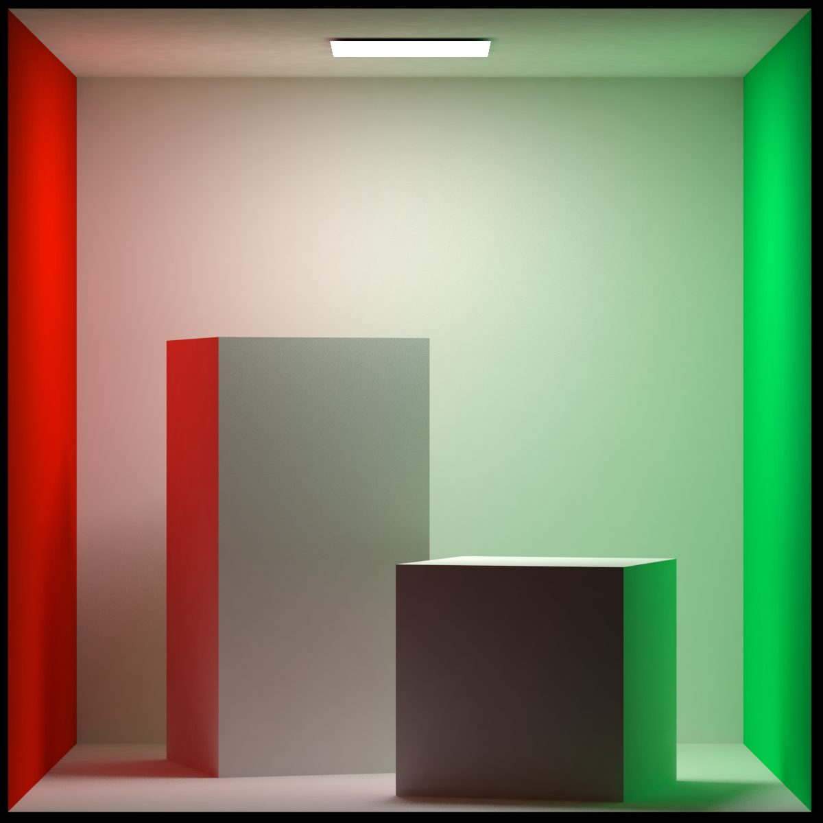

In the scene below, which is lit by a single Area Light at the top of the box, the ceiling surface is illuminated by global illumination only. Light from the Area Light diffusely reflects from the geometry in the box and is bounced back onto the ceiling.
Smooth Global Illumination enabled on the left, disabled on the right.

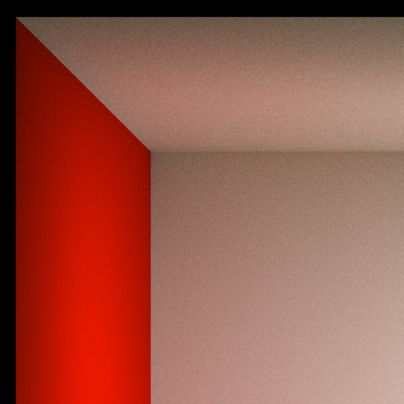

A cropped rendering of the top left corner more clearly shows the effect of Smooth Global Illumination.
