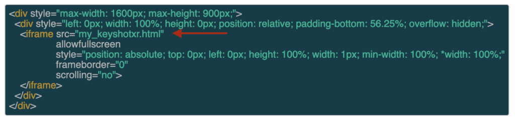

When you render your KeyShotXR the folder will also include instructions.html. Here you can find a section of code which almost can be copied directly into the WordPress editor on the page/post you want to embed it into. All you need to edit is the src url so it points to the location on the web server

The instructions.html includes a code preview of the iframe used for embedding the XR.
  • Make sure the src url location of the html file in the code matches the location of the upload.
  • If you are uploading to a secure website with SSL, make sure to use https instead of http in the src url.

The styling and divs around the iframe ensures that element works in a responsive layout. It will adapt to the width of the container, without loosing the aspect ratio.
<div style="max-width: 1000px; max-height: 1000px">  <div style="left: 0px; width: 100%; height: 0px; position: relative; padding-bottom: 100%; overflow: hidden;">    <iframe style="position: absolute; top: 0px; left: 0px; height: 100%; width: 1px; min-width: 100%;" src="https://mywebserver.com/my_keyshotxr.html" frameborder="0" scrolling="no" allowfullscreen="allowfullscreen"></iframe>  </div></div>
Replace following values
  • max-height/max-width: enter the size you rendered the KeyShotXR in
  • padding-bottom: the ratio between height and width in %. In this example it is 100% as the ratio is 1:1, a ratio of 16:9 would be 56.25%
  • src: enter the location of your KeyShotXR on the web server.
