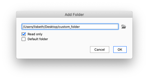

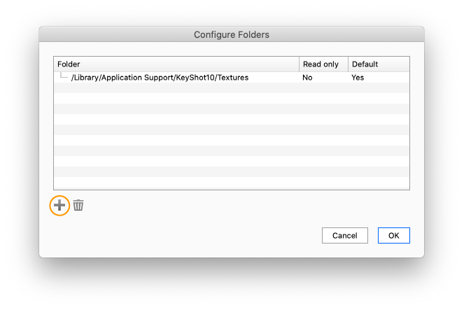

1. Select the folder icon next to the type you want to change.
2. In the Configure Folders window press the add icon
3. Browse to the folder you want to add and select if you want it to be the Read only or your Default folder. At least one default folder is required for each resource type.

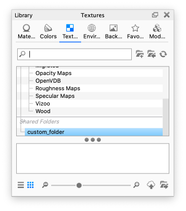

4. when you are done customizing your folders, KeyShot Studio will be restarted and now the folder will appear in the library.
Tip
Shared folders will allow you to point KeyShot Studio to access files in folders that are shared on a server or local computer. All shared folders will show inside of the KeyShot Studio Library.
