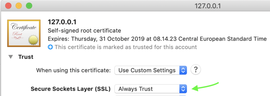

  • Open ca-crt.pem and ksnr-manager-crt.pem as shown below and set trust levels.

Trust Certificate
If you get the following error, or similar, when you try to connect to the Manager, you have to state that you trust the certificate:
Error: Connection error: The root CA certificate is not trusted for this purpose
macOS
  1. Double-click the certificate file and add it to the Login Keychain.
  2. Click My Certificates in the left pane and find the item with the domain name or IP you input above.
  3. Double-click that item and set it to Always Trust for Secure Sockets Layer (SSL).
