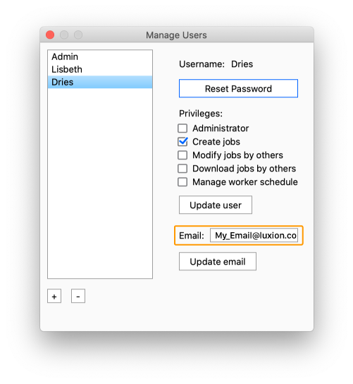

Add email address to user settings
  1. Log in to the Monitor File > Log In
  2. Click arrow next to your username in the top right corner of the monitor and select User Settings
  3. Select your user in the list
  4. enter or edit the email address associated with your user
