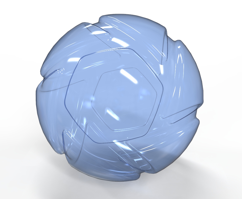

This is a simple Material Type for creating glass materials.
Compared to the Solid Glass material, this material type lacks the roughness and color density settings. However, it adds the two-sided option which is very useful when you have a part that is just a single surface (no thickness) and you want to make it reflective and transparent, but not refractive. This is commonly used for car windshields.
