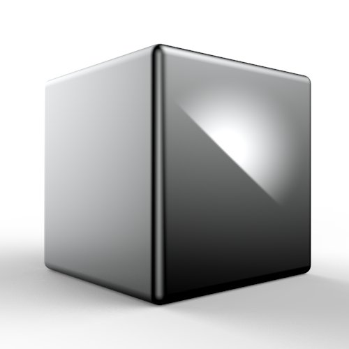

Overall a smaller resolution gives better performance, but a larger resolution gives better shadow and reflection quality. Normally it the default value will suffice. But if you are operating with highly reflective materials and half/square pins or pins with little/no falloff, you may need to increase the resolution.
On the left side of the slider, the environment resolution is low, on the right the resolution has been increased. Notice that the edge of the highlight is not as sharp as in the example you see if you pull te slider to the left, where the environment has a high resolution.
