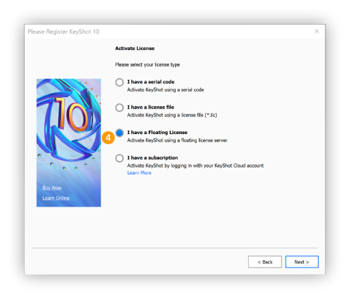

3. Select Activate my license and click Next.
4. Select I have Floating License and click Next.
