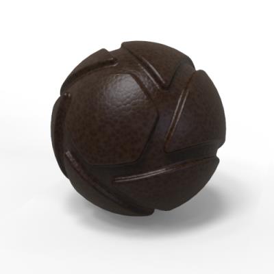

The Leather procedural texture allows you to easily replicate a leather textured material.
In this example the Leather texture is applied both as a diffuse and Opacity map.
