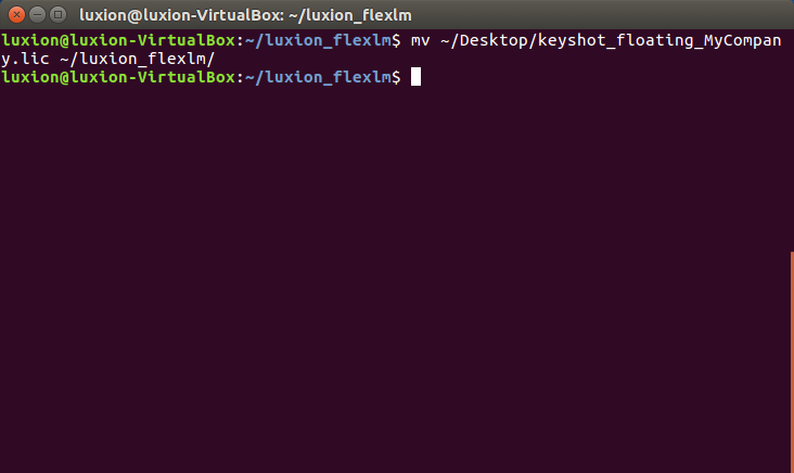

6. Move your license file to your luxion_flexlm folder, where your file would have your computer name instead of MyCompany.
mv ~/Desktop/keyshot_floating_MyCompany.lic ~/luxion_flexlm/

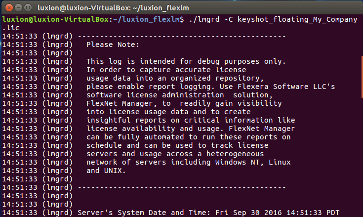

8. Run the following command to star the service, where your file would have your computer name instead of MyCompany.
./lmgrd -C keyshot_floating_MyCompany.lic
9. Run the following command to check the service status:
./lmstat -a
The lmstat output will confirm that the license server is up. The output message will also show you how many license seats are issued (available).
