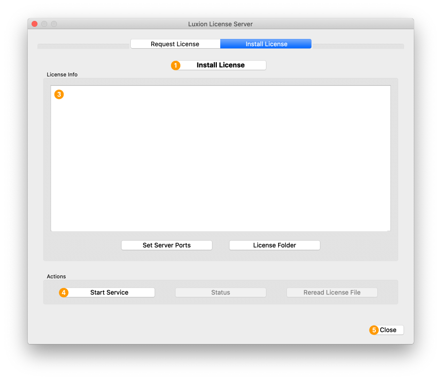

3. Install License
Click on the install License Tab to install the .lic file you have received from out licensing team.
  1. Click the Install License button.
  2. Locate and select the .lic file in the explorer/finder window.
  3. The License info is displayed.
  4. Check that the service is started.
  5. The KeyShot License Server window can now be closed, it is not necessary to keep it open for the floating licenses to be available, they can be accessed as long as the server is online, and the service is not stopped.
