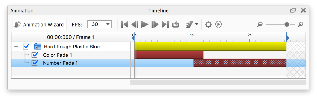

This will add a folder (yellow node) in the timeline witch contains all animations of the material. The Material animation nodes are represented as red nodes in the timeline.
