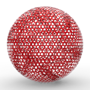

Here the mesh texture has been used as an opacity map to add holes in the surface, without having to model them.

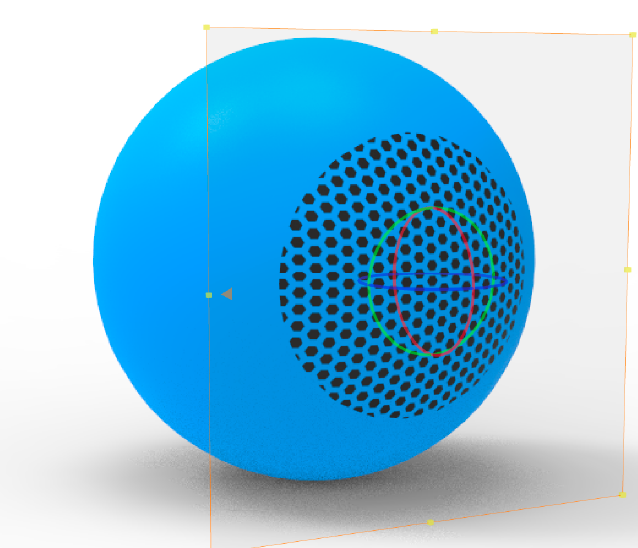

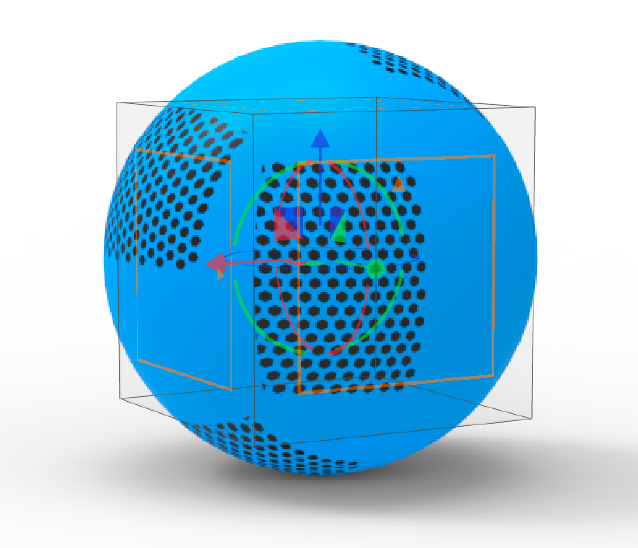

Depth (Planar mapping only)
If you don’t want the texture to apply to the entire object you can limit the dept of the texture. This way the texture will only apply to the areas on the surface that are within the depth measured from the position of the texture.
In the example, the planar texture is positioned exactly on the surface and has a depth of 0,2cm (the sphere is 2cm).

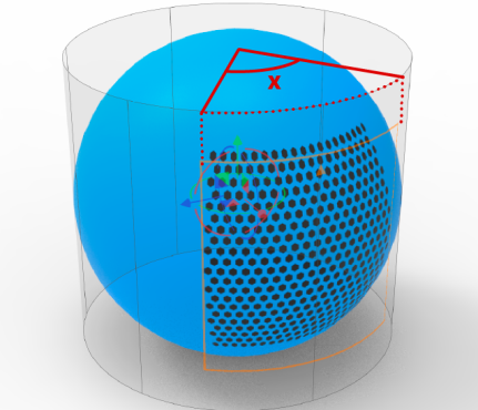

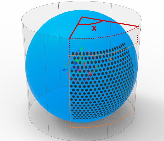

Wrap (Cylinder mapping only)
This determines width of the map that is wrapped around the cylinder, set by an angle measured from the center of the cylinder. The height will match the width.
Diameter (Cylinder mapping only)
This will adjust the diameter of the cylindrical map, measured from the center. If you want the diameter to match your object you can launch the Move Texture widget and press Fit to X/Y/Z.

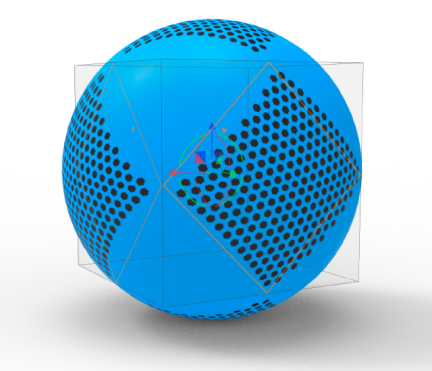

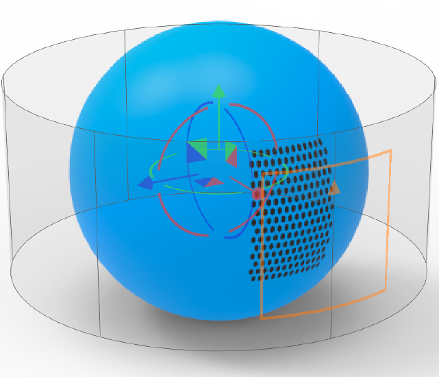

Shift U / Shift V (Box, Sphere, UV and Camera mapping)
Offsets the texture in the U or V direction without moving the center.
In the example the texture has been shifted -0,5 in the U-direction.

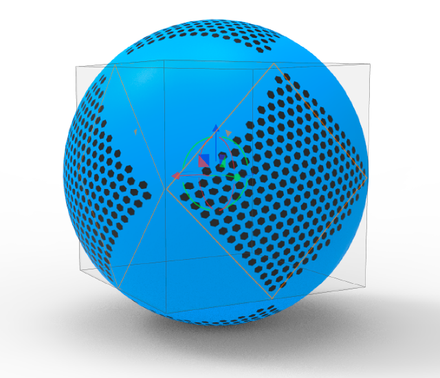

Angle UV (Box, Sphere, UV and Camera mapping)
This will rotate the UV plane of the Map.
In the example the texture is clipped and the UV is angled – notice the orange squares are rotated.
