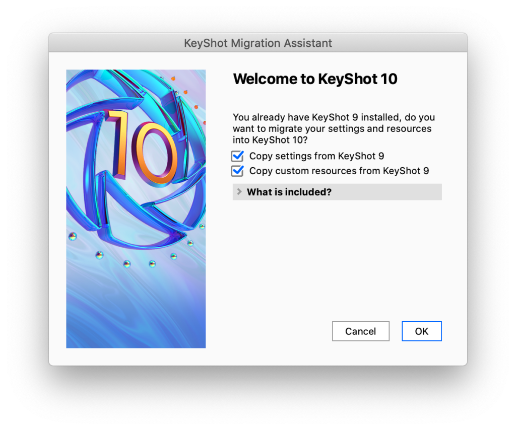

Migration Assistant
If you have a previous KeyShot Studio version installed on your PC/Mac, when installing KeyShot Studio for the first time, the Migration Assistant will help you transfer your settings and resources to your new KeyShot Studio. You can choose to migrate Settings, Resources or both.
Migrating Settings
You can migrate the following settings.
Preferences
Any alterations you have made to the default Preferences setup will be transferred.
Workspaces
You won’t have to re-create your favorite Workspaces.
Swatches saved in Color Picker
If you have added any color swatches to the the Color Picker, these will also be transferred.
License Information
  • Node Locked license: Information about name, company etc. will be prefilled in the Registration dialog.
  • Floating license: KeyShot Studio will connect to the same license server as you used in the previous KeyShot Studio version. If there are no licenses for KeyShot Studio 2025 on the server, KeyShot Studio will use the information from the previous version to prefill your server information in the Registration dialog.
Migrating Resources
You can migrate the following resourses.
Library resources
All non-stock resources will be copied into the respective KeyShot Studio 2025 libraries. Here they will be located in the Migrated folder.
If you have customized the folder settings all KeyShot Studio 2025 resources will be added to your custom folders.
Material Templates
Any Material Templates you have created will be copied to KeyShot Studio 2025.
Scripts
All custom scripts will be copied into your scripts list where they will be located in the Migrated folder.
