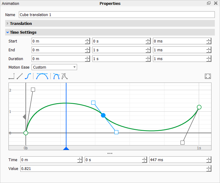

Custom Easing Curves
With custom easing you have full control of the easing curve. When you select the Custom easing curve the default will be a linear progression from start to end. Select one of the square handles and drag to change the easing.
Each keyframe determines the interval from the keyframe til the following keyframe. By default all keyframes will be curve points when you add them, but you can easily change the type:
Types of Keyframes
 Stepped:
This will keep a fixed value until the next keyframe in the timeline is reached.
 The stepped keyframe will by default not have a tangent handle opposite the stepped section, but you can add it via the Tangent handle icon. This way you can ease into/out from a stepped value.
 Use the value at the start of the interval.
 Use the value at the end of the interval.
 Curve:
Curve keyframes have tangent handles that can be manipulated to make the transition ease in/out.
 Lets you enable/disable the left/right tangent handles
 Keep tangent handles locked opposite to each other.
 Unlock tangent handles.
 Straight:
This is a variant of the curve point, where both tangent handles have been disabled by default. Simply click the tangent handle icons to make it a regular curve point.
Customizing the Easing Curve
Adding a keyframe: Double click in the grid or right-click and select Add Key to add a keyframe.
Setting the value: Select a keyframe on the curve and add the time and the value of it below the grid or simply drag it in the curve editor. Hold Shift to restrict to horizontal movement (adjusting time only).
Adjusting the curve: Drag the tangent handles to adjust the ease-in/out of a key. Hold Shift to restrict to horizontal movement.
Deleting a keyframe: Select a keyframe and press the Delete key or right-click the keyframe and select Delete.
Time indicator and work area: The curve editor has the same Time and Work Area indicators as the regular Animation timeline, enabling you to scrub through the timeline and limit the animation from the curve editor.
Move the Grid: Click and drag inside the grid to move the timeline.
Zoom in the grid: Click in the grid and use the scroll wheel or Ctrl +/- (Win) Cmd +/- (Mac) to zoom in/out.
Zoom to fit: You can fit the current curve in the curve editor simply by clicking the  Zoom to Fit button above the grid.
