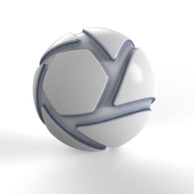

The Occlusion procedural texture allows for the addition of proximity-based shading on a material. It can be used to accentuate or augment the self shadows cast on a material and along with the Material Graph, create interesting texture effects based on occluded and unoccluded areas.
In this example the Occlusion texture is added as a diffuse map, enhancing shadows of the inside corners with a blue Occluded color
