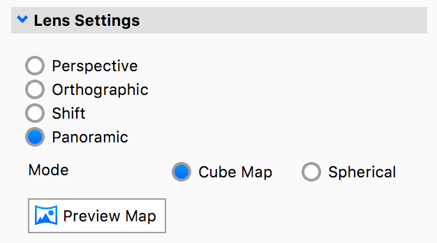

Using the Panoramic Camera
In the Camera tab, under Lens Settings, select Panoramic. Select your desired format of Spherical or Cube Map from the Mode radio buttons. The Real-time View will display a Panoramic Preview message at the top to indicate you are Panoramic mode. This means the camera can be rotated spherically and the real-time rendering in the Real-time View will not occur.
Cube Map Mode
When using the Cube Map Mode the Resolution in the Image tab will be locked at a 6:1 ratio. Cube Maps are essentially 6 squares that make up a cube, and they are primarily used with VR Headsets.
Spherical Mode
When using the Spherical Mode the Resolution in the Image tab will be locked at a 2:1 ratio. Spherical maps are 1 image and they can be used to create EXR images.

Preview Map
Click the Preview Map button to open a flat preview of your Panoramic image.
