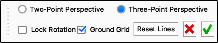

Two-Point Perspective
This is the mode used in most cases.
Adjust the vanishing lines according to the plane on which the object is placed.
Three-Point Perspective
Three point perspective is most commonly used when trying to place building or object when the camera is placed at a low or high eye level.
Adjust the perspective with 3 sets of orthogonal lines to match the vanishing points to the plane on which the object is placed and of vertical lines. Make sure the up axis of the matched perspective is the same as the one in the scene.
Lock Rotation
When the rotation is locked any adjustments to the 3 sets of lines will not affect the azimuth.
Ground Grid
Turn on ground grid in the scene to help match the perspective. the grid will not be visible in rendered output.
Reset lines
Reset all sets of lines to their default position. The camera will update accordingly.

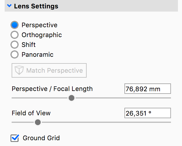

Perspective / Focal Length
The Perspective / Focal Length controls the amount of distortion (convergence) seen in the Real-time View. Real world values can be used here to replicate camera lens focal lengths.
Field of View
Field of View (FOV) is inversely related to Perspective and controls the “cone of vision” seen in the Real-time View. Larger Perspective values will result in a smaller Field of View, while smaller Perspective values increase the amount that’s visible in the Real-time View.
Ground Grid
Ground Grid will overlay a 1:1 grid on the KeyShot Studio ground plane; the density of the grid is controlled by the Environment size. This grid is useful for matching perspective and camera angles and will not be visible in rendered output.
