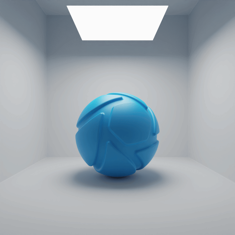

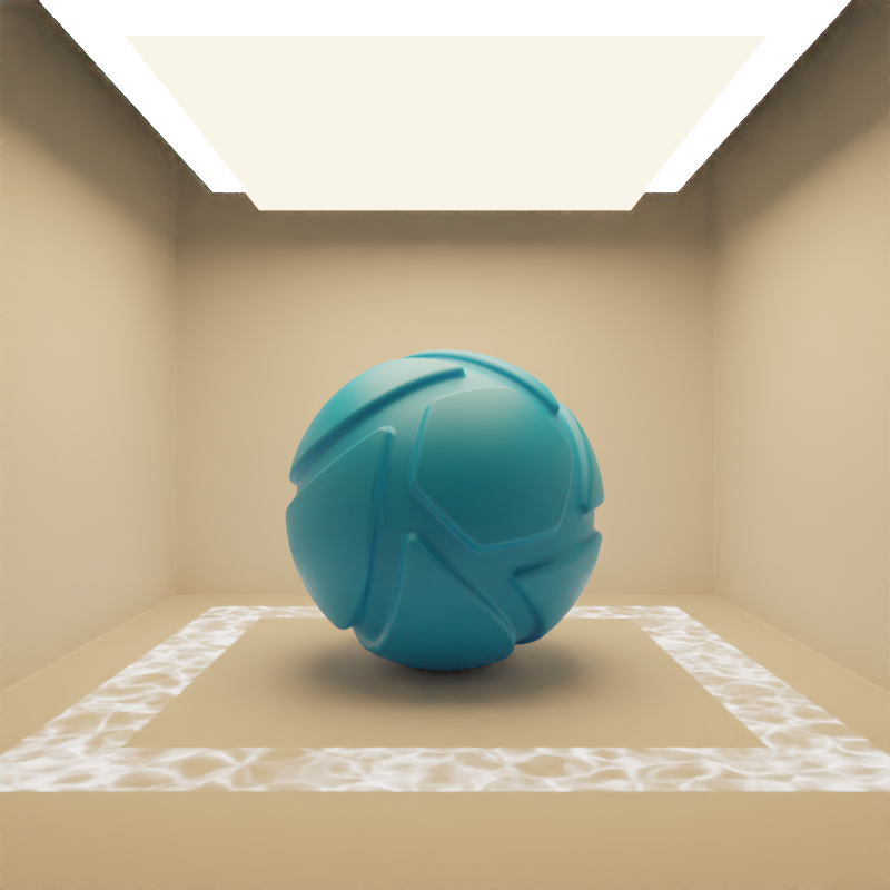

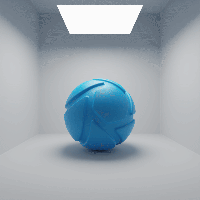

The example shows an planar light with a Color Gradient texture and animated, horizontal spread angles from 90° to 0°.
Color

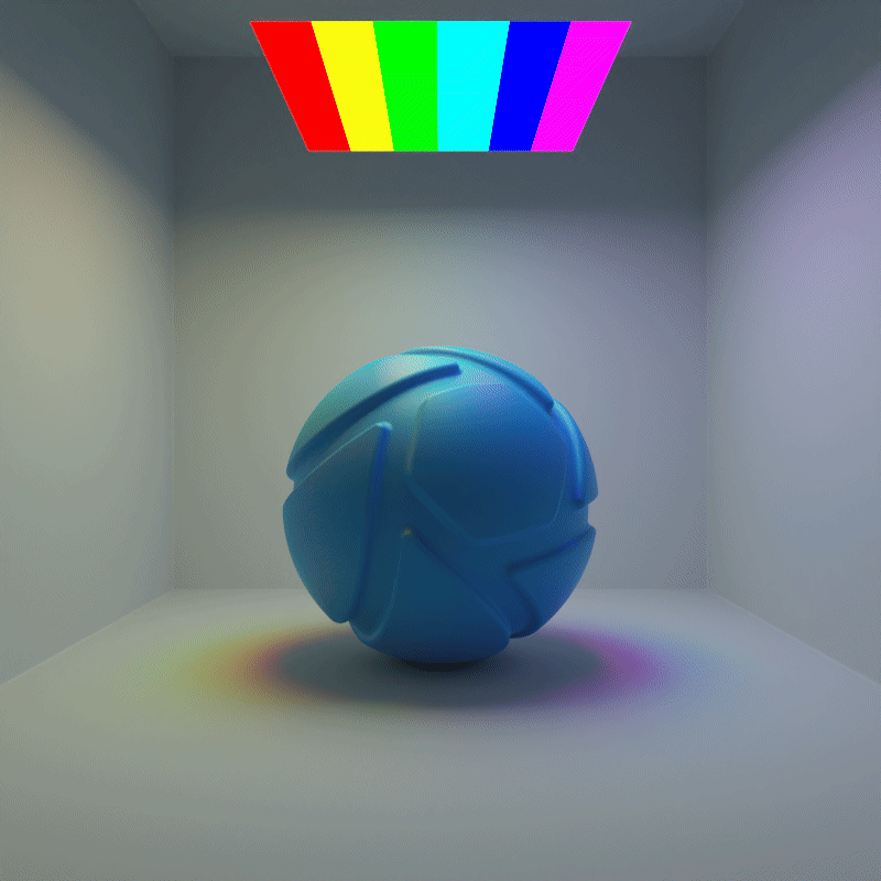

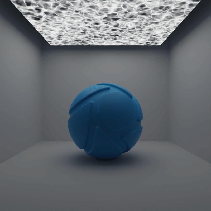

Here, you can choose the color the light will cast. You can also place a texture in front of the light source to color and mask the emitted light.

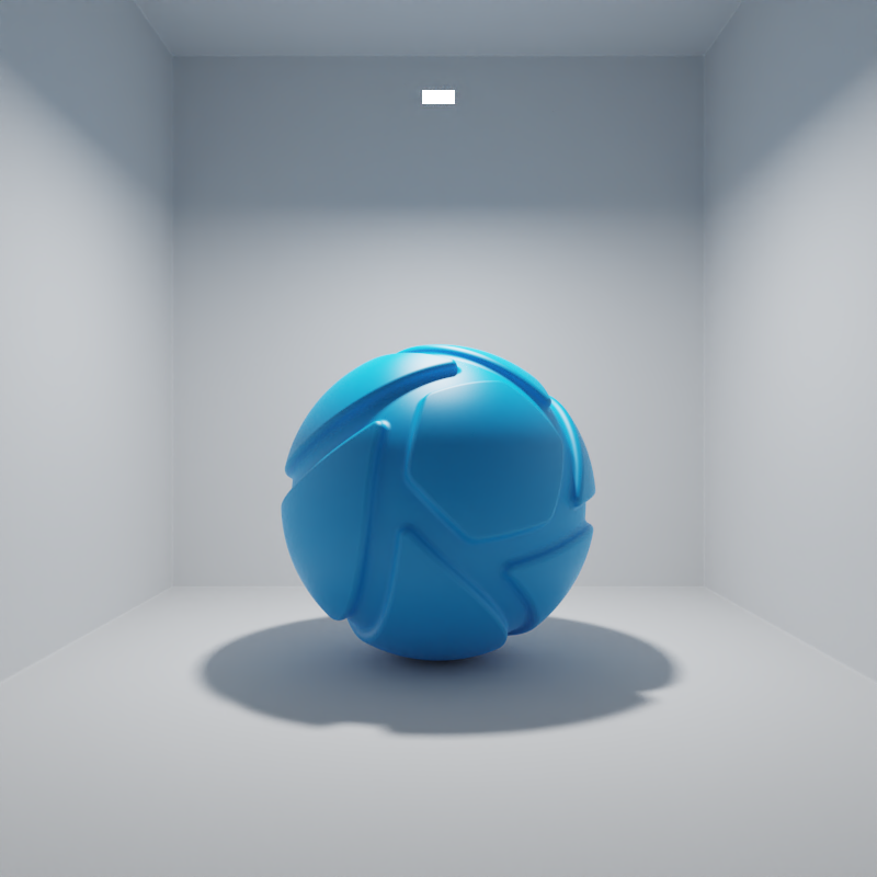

Lumen

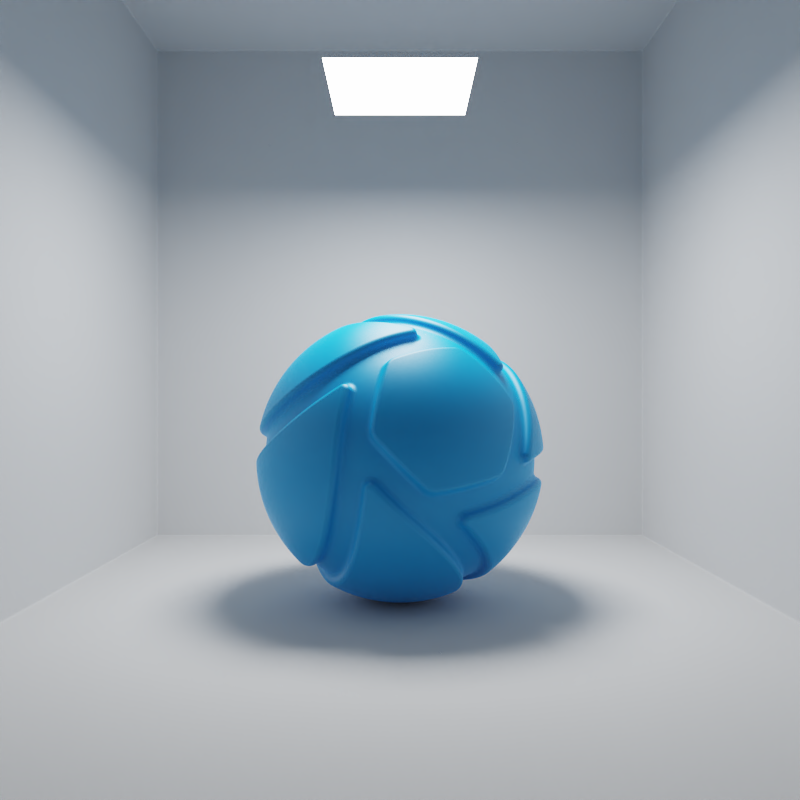

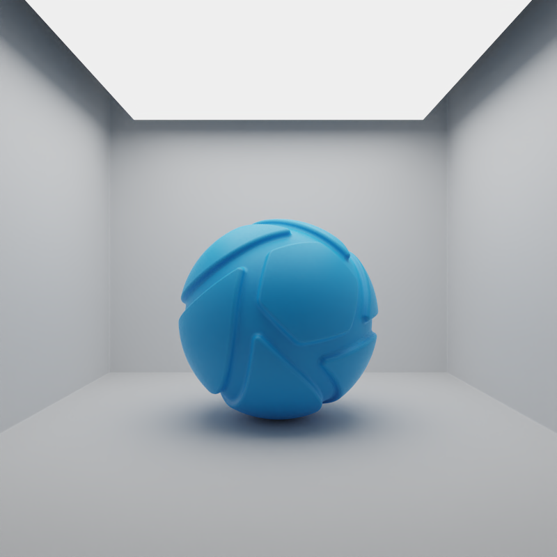

When the Power unit is set to Lumen, then the light output is specified as luminous flux. Total light output will be constant for planar light objects of different sizes.
The examples below show the effect of increasing the size of a square planar light from 10 to 200 mm. Power is a constant 250 Lumen.

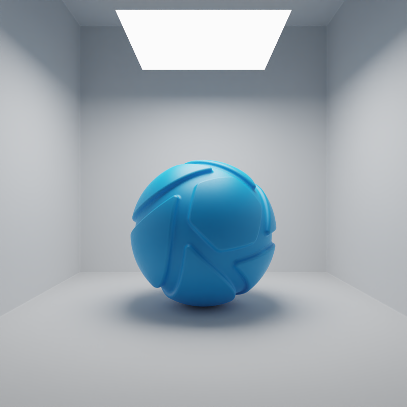

When the Power unit is set to Lux, then the light output is specified as luminous emittance. 1 Lux equals 1 Lumen per square meter of light-emitting surface. Total light output will vary for planar light objects of different sizes. Small planar lights are dim, while large planar lights are brighter, since the light-emitting surface planar is larger.
The examples below show the effect of increasing the size of a square planar light from 10 to 200 mm. Power is a constant 25000 Lux.

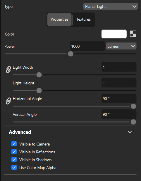

Size
You can adjust the physical size of the light in scene units, by adjusting the Light Width and Light Height.
For best results, adjust the size of the light here via Light Width and Light Height, as opposed to the scaling option in the Scene Tab.

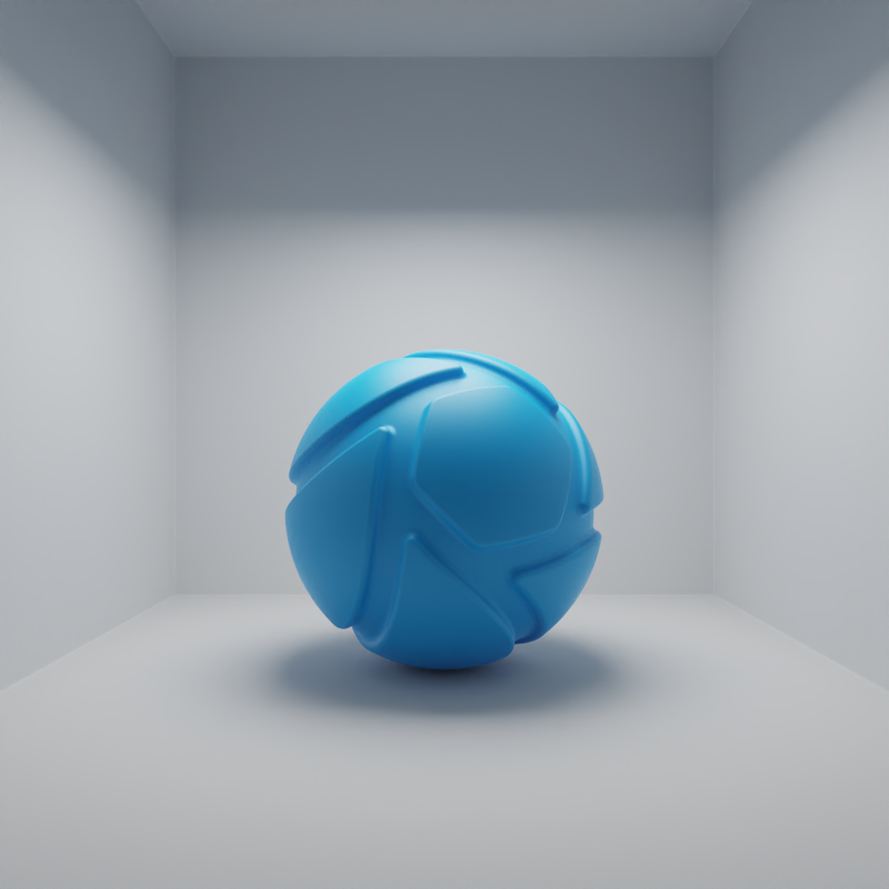

Spread Angles

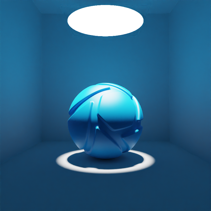

The spread angles enable you to adjust the directionality of your lighting. Wider angles result in more diffuse light and softer shadows. Smaller angles give you more directional light and sharper shadows.
| Horizontal Angles 90° to 5° | Vertical Angles 90° to 5° | All Angles 90° to 5° | Gobo Texture 90° to 0,25° |

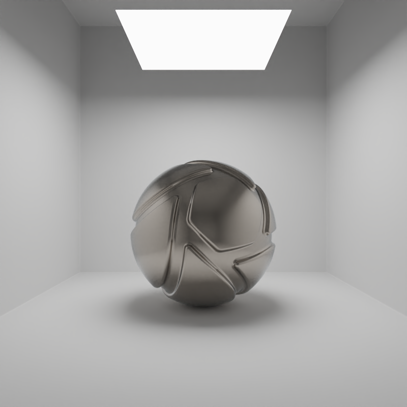

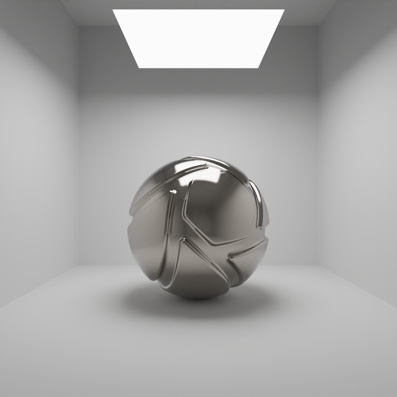

Visible in Reflections
Here, you can toggle whether or not the reflection of the light source is shown in real-time window and renderings.
The examples below show the effect of toggling visibility in reflections both with a Plastic and a Metal material.

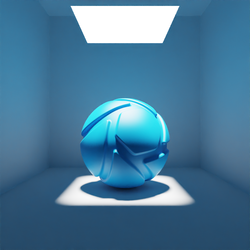

Visible in Shadows
Here, you can toggle whether or not the light source geometry casts a shadow in the real-time window.

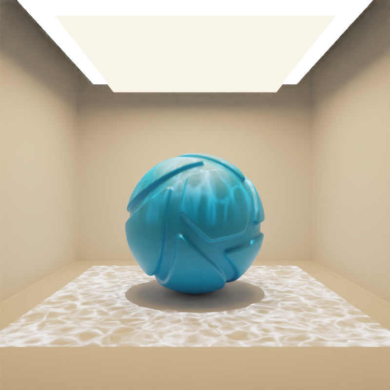

The example below shows the effect of toggling visibility in shadows. The scene is lit by a large planar light with a cold color, a Gobo Texture and spread angles at 0,2°. Directly below it, there is a slightly smaller planar light with a warm color and 90° spread angles. Visible in Shadows is toggled for the smaller, warm planar light.
Visible in Shadows = ON |
Visible in Shadows = OFF |
