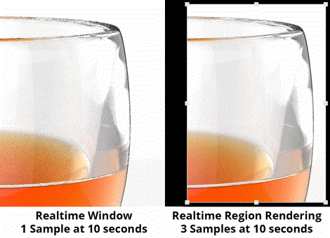

Side-by-side comparison of a layered glass material with and without enabling Real-time Region Rendering below. In this example, the Region render image resolves 300% faster.

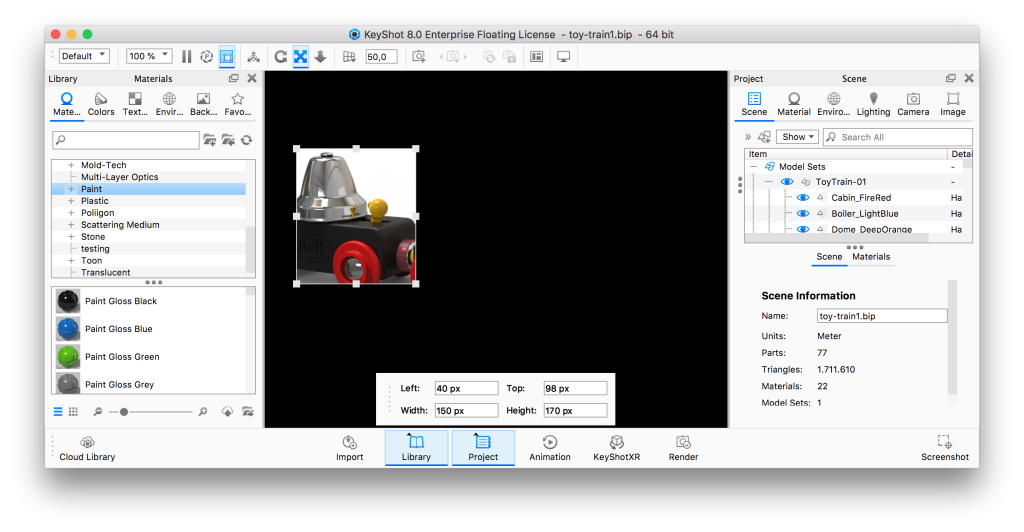

Render Region Setup
The smaller the region (and less complicated the materials and lighting), the faster the render will resolve. Both types of region rendering are set up in the same way. When region rendering is enabled you can control the region area size and position in two ways:
  • Real-time View
    Adjust region size: click and drag the corners or edge handles of the region area.
    Move the region: click and drag inside the region to move the entire area.
  • Position Panel
    Adjust region size: Enter the Height and/or Width or the render region.
    Move the region: Enter Left and/or Top (distance from the top-left corner).
    Move the panel: click and drag the left side of the panel to re-locate it anywhere in the Real-time View.
Both can be used together as well and the camera can continue to be adjusted by clicking and dragging in the black area surrounding the render region.
