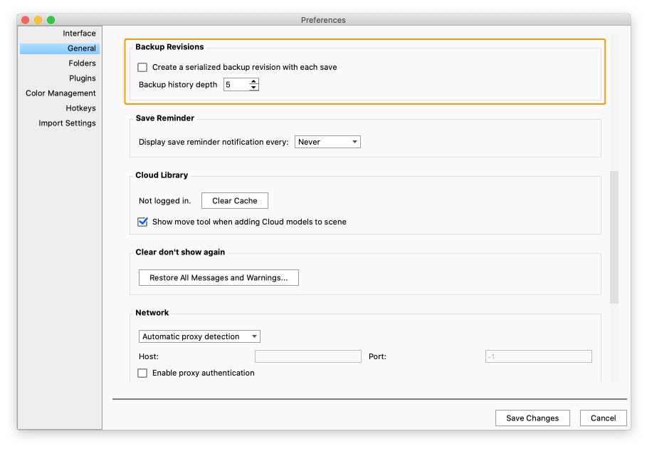

Enable Revision Manager
You enable the Revision manager in Preferences
  • WindowsEdit > Preferences > General > Backup Revisions
  • MacKeyShot Studio > Preferences > General > Backup Revisions
The Backup history depth enables you to control how many revisions are saved.

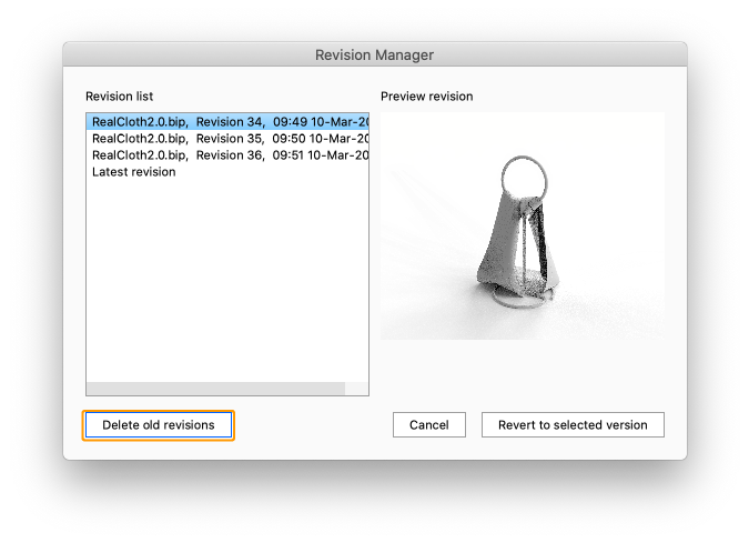

The instructions below assume that you’ve enabled Backup Revisions, and that you’ve saved your scene at least twice.

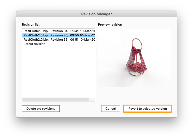

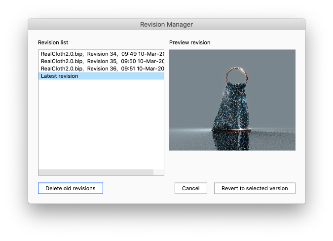

1. With your scene open, go to File > Revision Manager. The Revision Manager window appears.
2. From the Revisions list, select the version (revision) of your scene to which you wish to revert. Then, click Revert to selected version.
3. To delete old revisions, simply click Delete old revisions.
