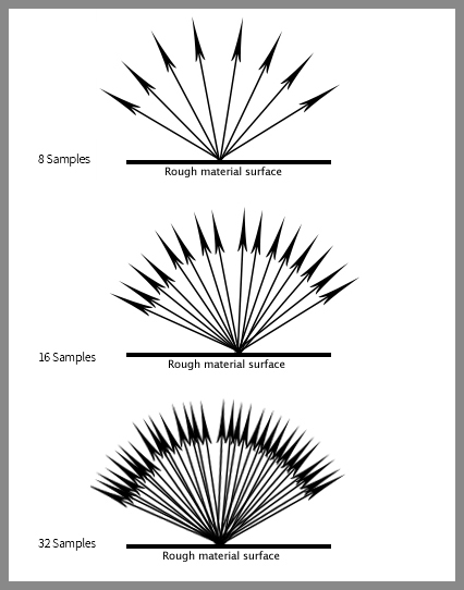

Samples
Since glossy materials with some roughness are more complex to render, KeyShot Studio has a setting built in that can improve the accuracy of these rough materials. This setting is called Samples. This allows you to set how many rays are emitted from a pixel in a rendered image. Each ray collects information from its surrounding environment and returns this information back to the pixel to determine the final appearance. You will see the Samples slider when you click the expand arrow next to the Roughness slider.
Interior Mode uses a different and more intelligent approach to samples than the one Product mode uses. The improved approach means that customization of Samples only has effect in Product Mode as it is not necessary in Interior Mode.
