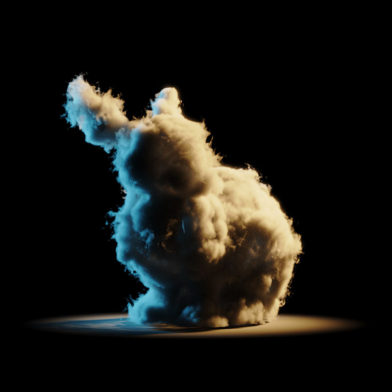

With scattering medium you can simulate particle scattering to create such effects as fog or smoke or volumetric lighting such as visualizing beams or rays of light.
Scattering medium with a Volume map applied to the Density texture.
