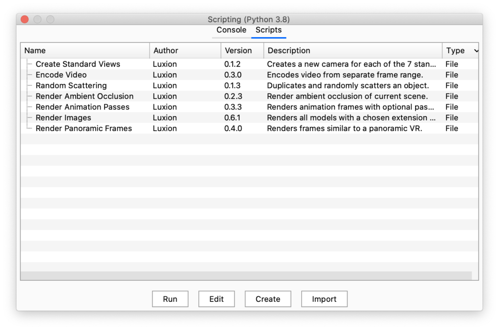

In this page you will find KeyShot Studio’s predefined scripts and instructions on how to use them.  These scripts are listed under the Scripts tab inside the Scripting window.
Create Standard Views
Creates seven standard view cameras: front, back, top, bottom, left, right, and isometric.
  • Select script and press Run. You will receive confirmation message: Successful!
  • Click OK.
  • You will find the seven standard views under Project > Camera.
