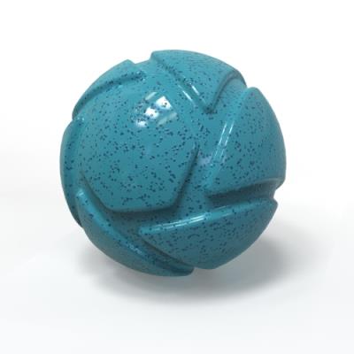

The Spots procedural texture is a an interactive method of creating a texture map of scattered spots on a surface.
In this example the Spot texture is applied both as a Diffuse map and as an Opacity map.
