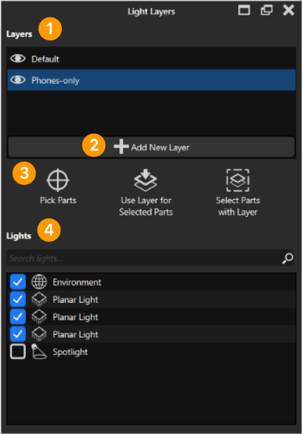

Working with Light Layers
  1. List of Light Layers
    A list view of all the Light Layers in your scene
  2. Add new Layer
    Adds another Layer to your scene
  3. Buttons
    1. Pick Parts - This will open a selection dialog to help you select the part(s) you want to be affected by the Layer.
    2. Use Layer for Selected Parts - If you have one or more parts selected in the real-time view, you can use this button to apply the Layer to these parts.
    3. Select Parts with Layer - This selects all parts that are affected by the active Layer.
  4. List of Lights
    A list of all lighting in your scene.
