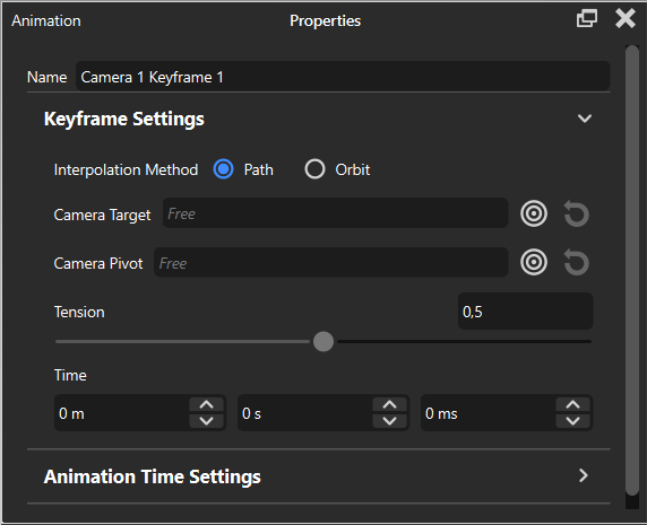

Keyframe Settings
These settings are saved individually to each Keyframe on the Animation Timeline. This allows you to have different settings on each of your Keyframes.
Interpolation Method
The Interpolation Method defines your cameras behavior between two different Keyframes. The Path Method will move the camera in a straight line, while the Orbit Method will try to preserve the distance to your target, creating an Orbit.
Camera Target
The Camera Target allows you to set a specific object, that your camera should keep as a target.
Camera Pivot
The Camera Pivot allows you to set a specific object, that your camera should rotate around.
Tension
This enables you to adjust the sharpness of the path. Increasing the value will sharpen the change in direction at the Keyframes while lower values will produce a smoother path.
Time
The Time setting allows you to set the exact time of your Keyframe on the timeline.
