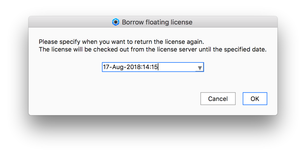

How To Borrow A License
  1. Ensure that your client computer can connect to the server,
  2. Open KeyShot Studio Floating.
  3. Windows: In the Main menu click Help > Borrow Floating License.
    Mac: In the Main menu click KeyShot Studio> Borrow Floating License.
  4. Select a return date and click OK.
  5. You will receive a confirmation message. Click OK

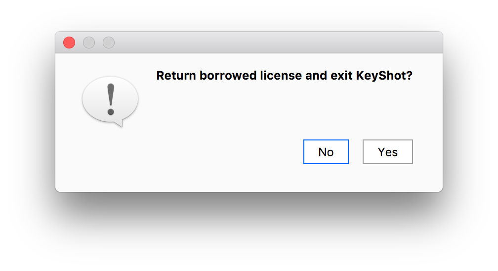

How To Return A Borrowed License
  1. Ensure that your client computer can connect to the server (otherwise, this will not work).
  3. Windows: In the Main menu click Help > Return Borrowed Floating License.
    Mac: In the Main menu click KeyShot Studio> Return Borrowed Floating License.
  4. You will be asked to confirm this action. Click Yes.
