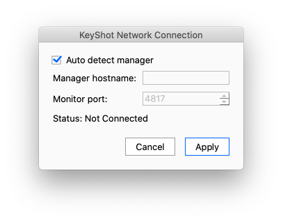

Auto Detect Manager
By default Network Rendering is set up to Auto detect manager and workers/clients.
Worker and manager will just have to have the same port numbers specified in the Network Configurator and when you connect the Render Queue you only need to keep the Auto-detect option checked, when you connect. You find the connection dialog in the Render Queue menu File > Connection Settings…

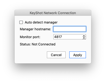

Manually Connect to Manager
If Auto Detect is not enabled, or your network operates with Multiple Managers you can specify the Manager in the Connection Settings.
Disable Auto detect manager and fill in the manager hostname (or IP Address) as well as the port number.
