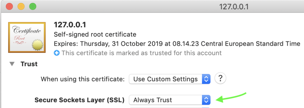

macOS
  1. Double-click the certificate file and add it to the Login Keychain.
  2. Click My Certificates in the left pane and find the item with the domain name or IP you input above.
  3. Double-click that item and set it to Always Trust for Secure Sockets Layer (SSL).
