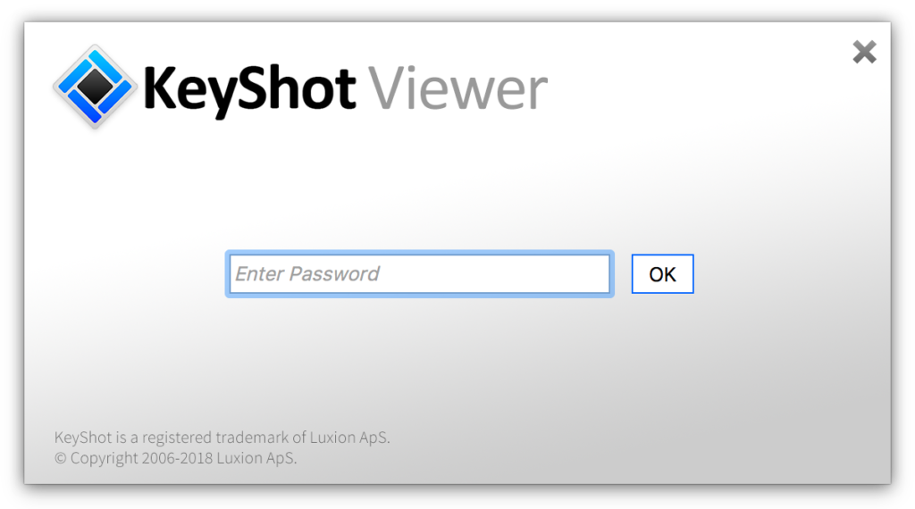

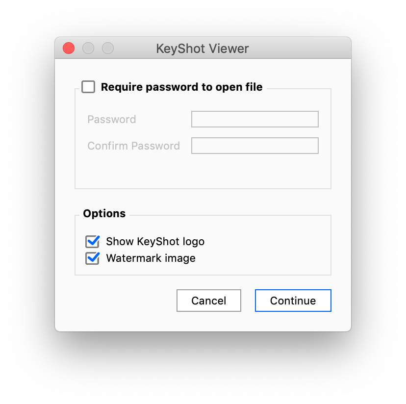

Saving for KeyShot Viewer
Depending on how the scene was saved from KeyShot, you may be prompted to enter a password.
KeyShot Viewer enables you to share a scene with someone who doesn’t have KeyShot. You can share regular scenes, as well as Configurator scenes. The viewer can open regular KSP files, but you can also Save For KeyShot Viewer, which will allow you to password protect the scene and/or add logo and watermark overlays to the scene.

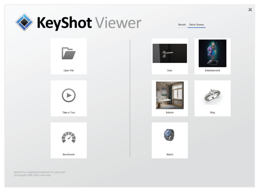

When KeyShot Viewer is launched you will be prompted with a splash screen where you can browse to open a file, take a tour, run benchmark mode, select from those recently opened, or open a demo scene.
You can also open .ksp files by dragging and dropping onto the splash screen, into the KeyShot Viewer application window, or by the file menu if a scene is currently open.
The file menu is accessible when the application is in a windowed state, which can be reached from full-screen presentation mode by pressing the Esc key or clicking the  exit icon. To enter full-screen presentation mode again, maximize the window or click the  presentation mode icon.
KeyShot Viewer comes with several demo scenes. Additional configurator scenes can be found here.
KeyShot Viewer splash screen.

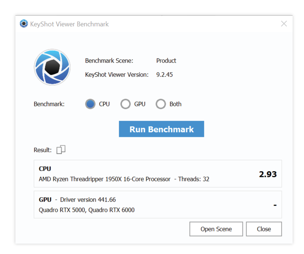

Running the Benchmark:
You can choose to run a benchmark test for CPU, GPU, or both. Choose one of those options, then select Run Benchmark. A window showing the progress of the benchmark test will open.
Comparing Results:
To get a realistic base for comparing benchmark scores, make sure they are generated on the same version of KeyShot VIewer. Results will be shown in the KeyShot Viewer Benchmark window under either CPU, GPU, or both, depending on what test was run. The resulting numbers are multiples based on render time. A score of 1.0 is based on an Intel(R) Core(TM) i7-6900K CPU @3.20GHz, 2601 Mhz, 8 Core(s).
For example, a system with the same rendering speed as the machine listed above would have a factor of 1.0.
A CPU that is double that speed would result in a factor of 2.0.
The GPU benchmark follows the same CPU baseline. However, the significant differences in the technologies between CPU and GPU make comparison difficult and should be taken lightly.
Any differences in the resulting numbers between several different benchmark tests are likely due to different loads on the computer, such as other applications running in the background.
KeyShot Viewer Benchmark window depicting CPU benchmark results.

The option to add watermark and powered by KeyShot is included when exporting a KeyShot Scene for KeyShot Viewer.

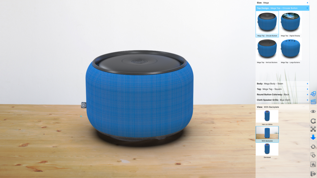

Studio, Model, and Material variations
KeyShot allows you to present a configurator for unlimited Studio, Model and Material variation.
Users of KeyShot can use the Configurator to include Studio, Model, and Material variations, which will be available when KeyShot Viewer is in full-screen presentation mode. Simply click or tap on any of these variations to update the real-time view. Use the tabs to navigate the various options that have been setup in the scene.
For information about using the Configurator in KeyShot, to setup Studio, Model, and Material variations for output to KeyShot Viewer click here.
The  auto-hide icon allows you to hide the Studio, Model and Material variation panels after 10 seconds of inactivity. To show again simply mouse over or tap in the area the panels occupy.

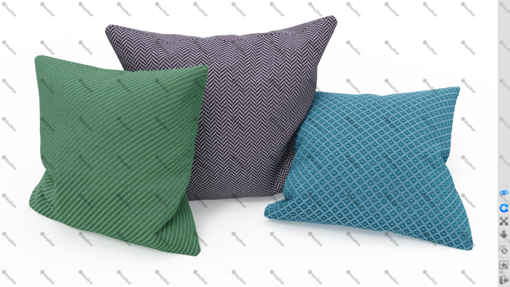

  1. How do I remove the watermark logo pattern?
    The inclusion of the KeyShot watermark logo pattern is defined when saving for KeyShot Viewer from KeyShot. You will need to ask the provider of the file to remove this.
  2. How do I remove the “Powered by KeyShot” logo in the upper right corner?
    The inclusion of the “powered by KeyShot” logo is defined when saving for KeyShot Viewer from KeyShot. You will need to ask the provider of the file to remove this.
