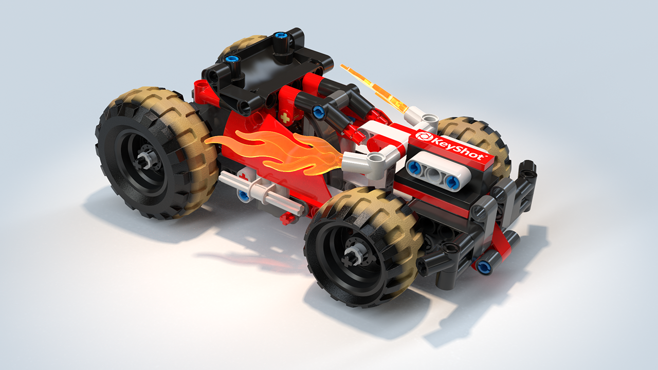

On the left you see the rendered beauty pass for reference, on the right is the composited result.

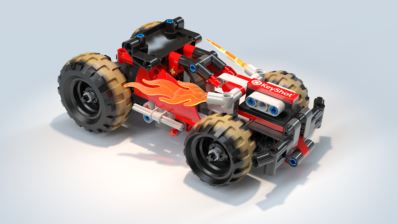

On the left you see the rendered image (beauty pass) on the right is composited result, of the beauty pass + reflection.

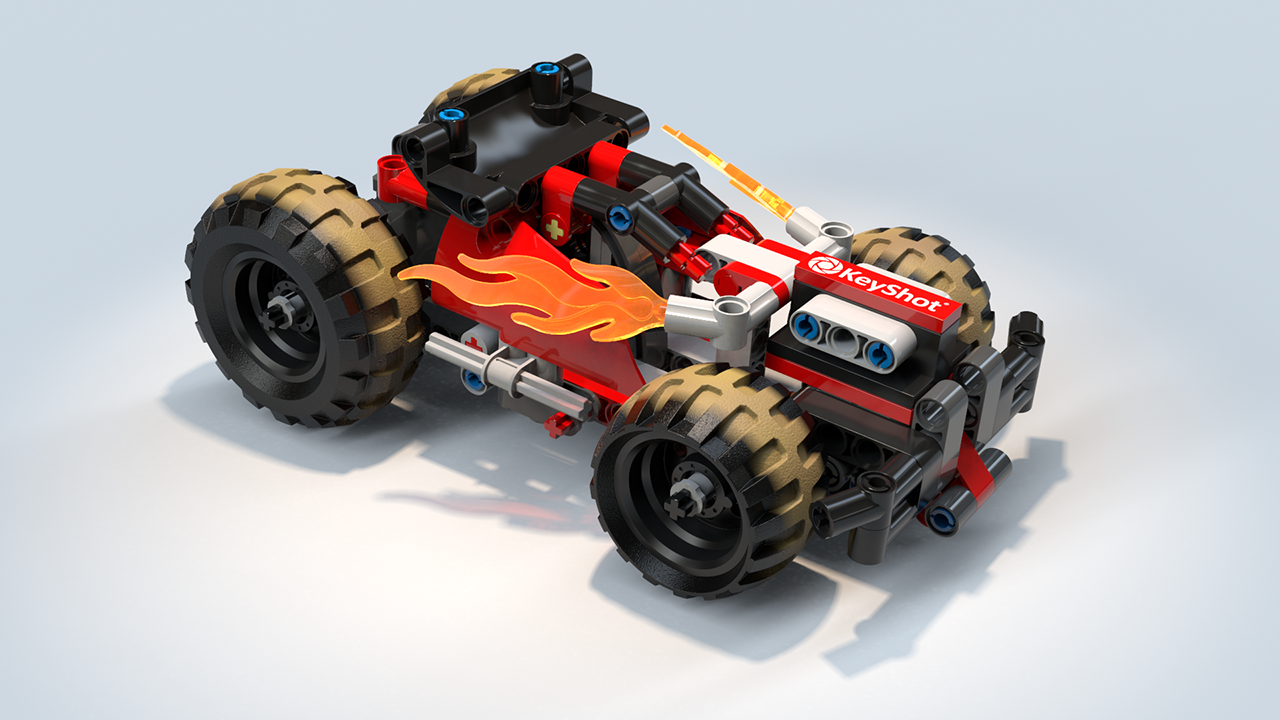

On the left you see the rendered image, on the right is the composited result of the beauty pass + global illumination.
