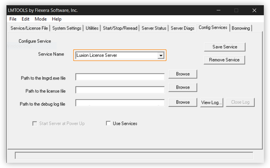

2. Launch the LMTools application (found inside C:\Program Files (x86)\KeyShot License Server) and go to the Config Services tab.
3. Write a new service name.

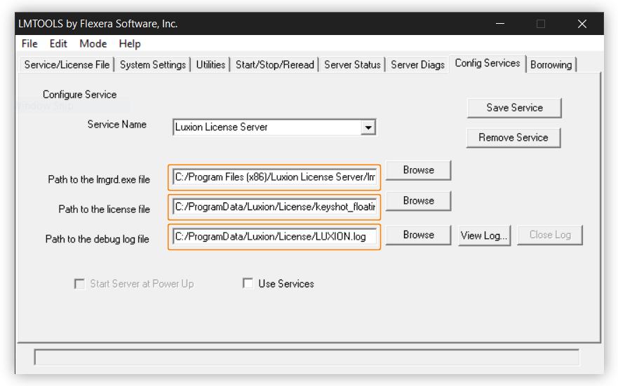

4. Browse to the lmgrd.exe, license (.lic), and debug.log files. You should be able to find all of these files in your C:\Program Files (x86)\KeyShot License Server folder. Note that the debug log is created after you start the service. For now, you can simply specify the correct path: C:\ProgramData\KeyShot\License\LUXION.log

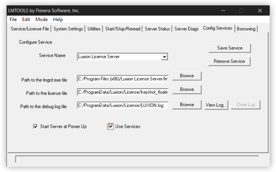

5. Enable Start Server at Power Up and Use Services. Then click Save Service and confirm.

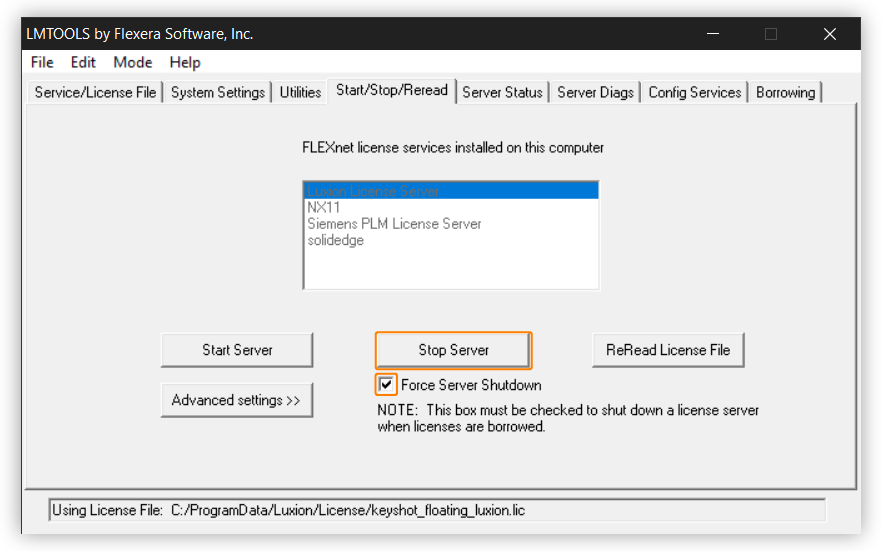

6.  Go to the Start/Stop/Reread tab. Enable Force Server Shutdown and click Stop Server.  You may also stop the KeyShot License Server within the Windows Services dialog (services.exe).

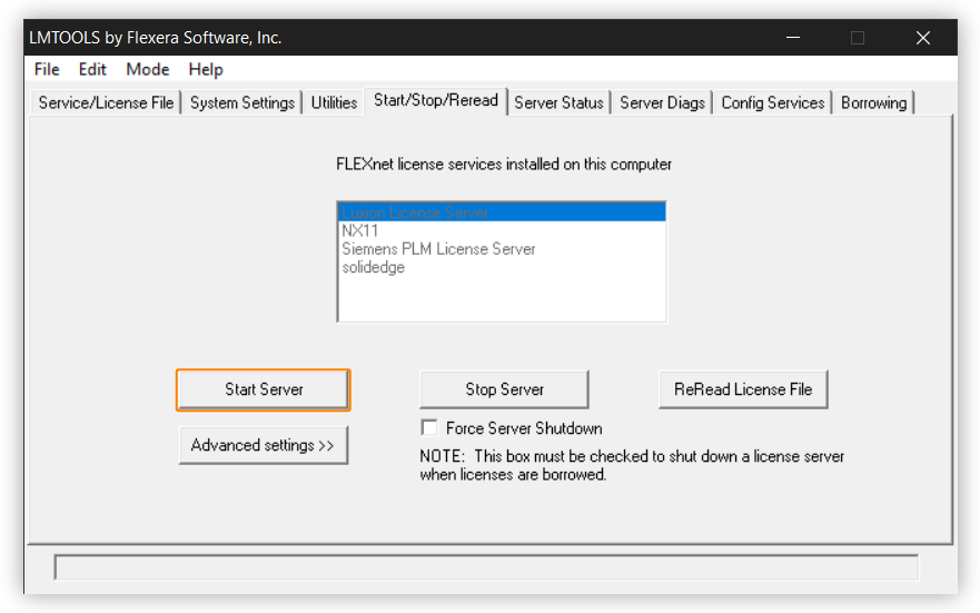

7. Click Start Server.  You may also start the KeyShot License Server within the Windows Services dialog (services.exe).

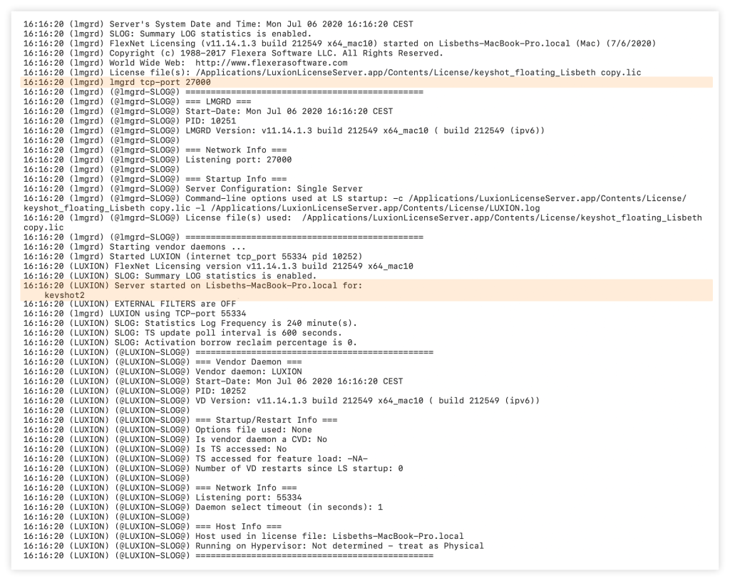

8. Open the LUXION.log file inside your C:\ProgramData\KeyShot\License folder (this folder contains the licensing software). The debug log will reference your license file and tell you that the server started on your computer system.
License server log: The highlighted sections show the port and server name.

If your debug log does not look similar to the above image or if you are getting an error message inside Floating License Configurator, then you can use the troubleshooting guide for guidance.
