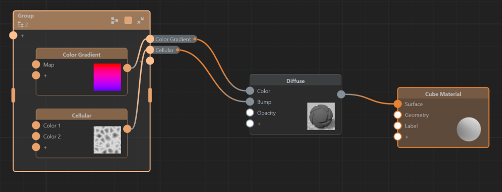

Node Groups are customizable, collapsible node containers, that can help you keep your Material Graph organized and tidy. Node Groups also make it easy to reuse parts of your Material Graph.

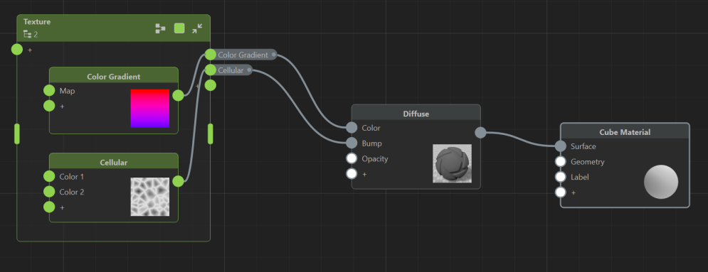

Customize your Group
You can customize your groups by giving them a name, choosing a color, and changing the size of the group container.
