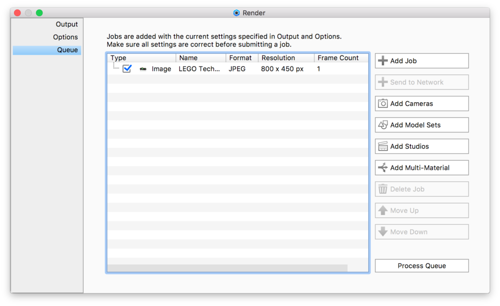

The Render Dialog Queue is used for batch processing your still image, animation, KeyShotXR, and Configurator rendering jobs.
The Queue displays the job type, name, format, resolution, and frame count. You can hover over a job to see a larger thumbnail preview, when the job was added, the render mode and number of samples.
Add/Delete Job
Use these buttons to add and remove jobs from the queue list. Jobs are added with the current settings specified in Output and Options. Each job can have unique settings.

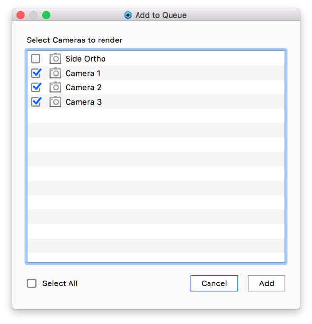

Add Cameras
Send saved Cameras to the Render Dialog Queue. This button is active if more than one Camera exists. Click the Add Cameras button to open the Camera Queue window and check the Cameras you want to add to the queue.

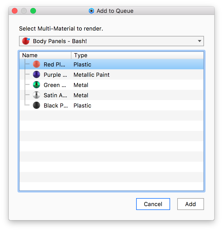

Add Multi-Material
Send sub-materials of a selected Multi-Material to the Render Dialog Queue. This button is active if one or more Multi-materials exist in a scene.
Click the Add Multi-Material button to open the Multi-Material Queue window and select a Multi-Material. When you press Add, a rendering of the scene showing each of the sub-materials of the selected Multi-Material will be added to the Queue. The rest of the Multi-Materials in the scene will be shown with the sub-material currently active in the Real-time View.

Move Up/Down
You can select a job in the list and click Move Up or Move Down to change the order of the job in the list. Jobs at the top render first. You can use the check box next to the job to turn off that job. The job will then be skipped during processing of the queue.
Process Queue
When you are ready to start the queue, click the Process Queue button. All jobs with a blue check-mark will be processed. You can enable/disable a multi-selection of jobs via the right-click menu.
