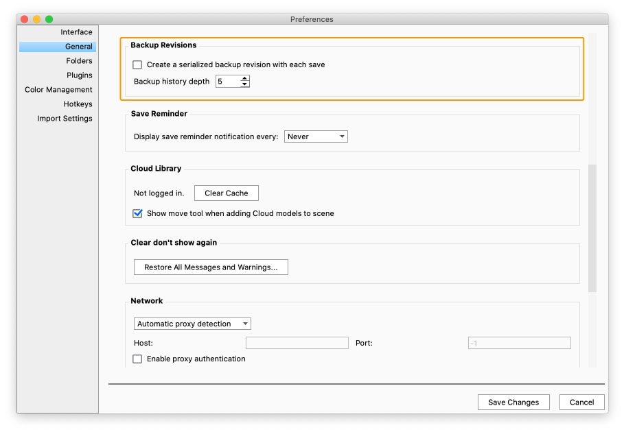

You enable the Revision manager in Preferences
  • Windows: Edit > Preferences > General > Backup Revisions
  • Mac: KeyShot Studio > Preferences > General > Backup Revisions
The Backup history depth enables you to control how many revisions are saved.

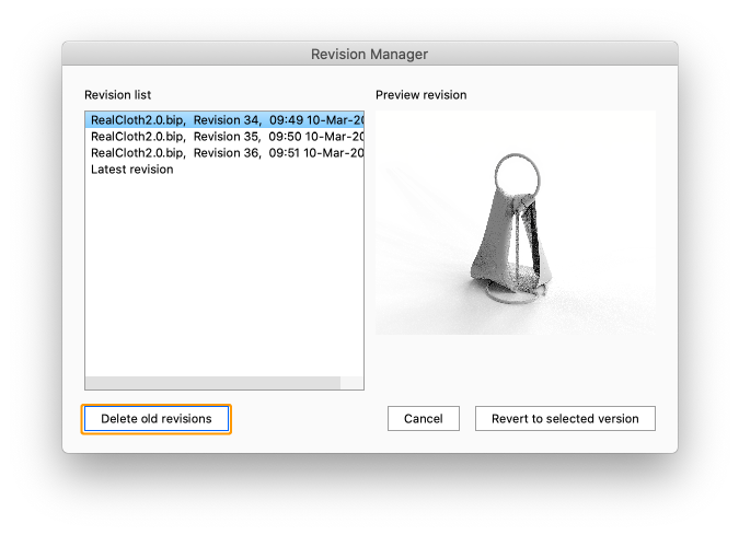

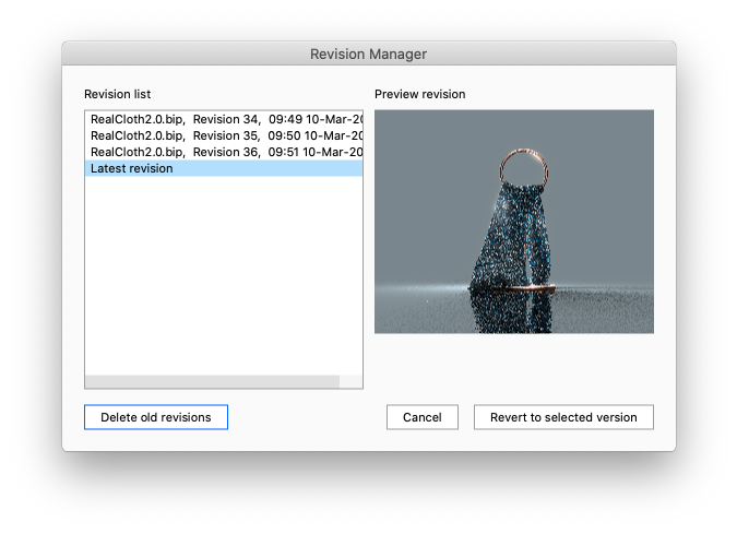

1. With your scene open, go to File > Revision Manager. The Revision Manager window appears.

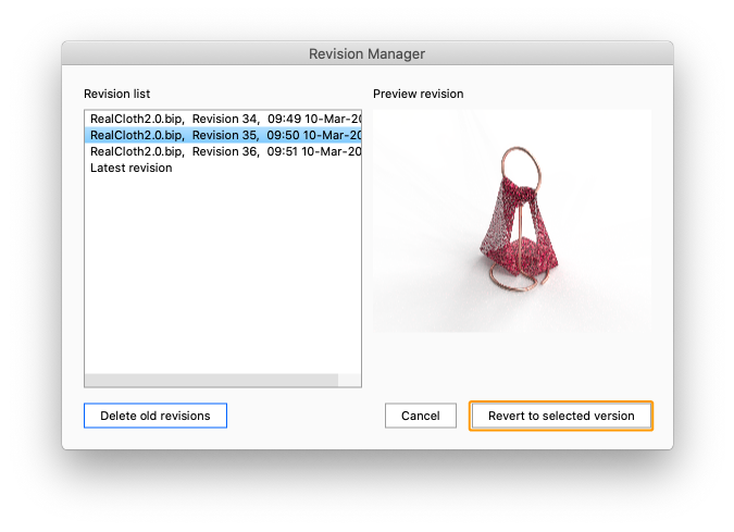

2. From the Revisions list, select the version (revision) of your scene to which you wish to revert. Then, click Revert to selected version.
3. To delete old revisions, simply click Delete old revisions.
