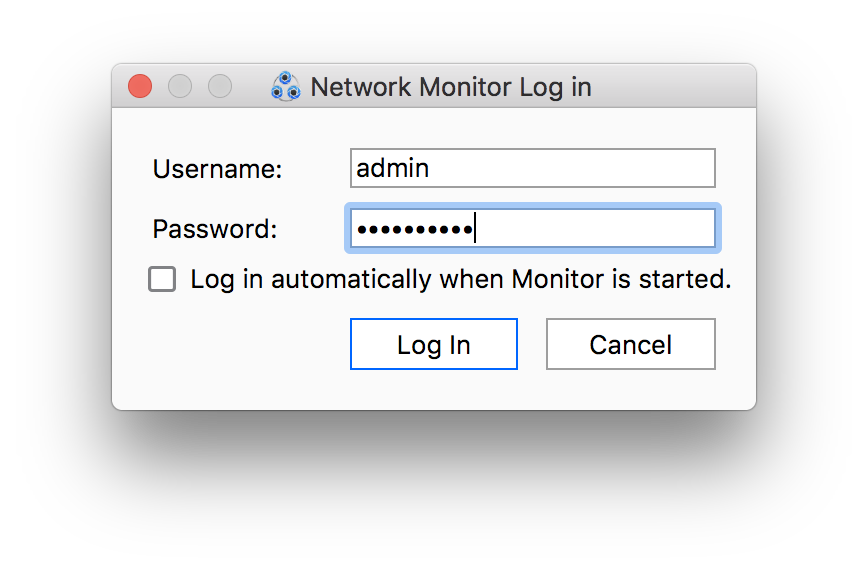

1. Log In
Launch KeyShot Render Queue, click File > Log in and log in with your administrator credentials.

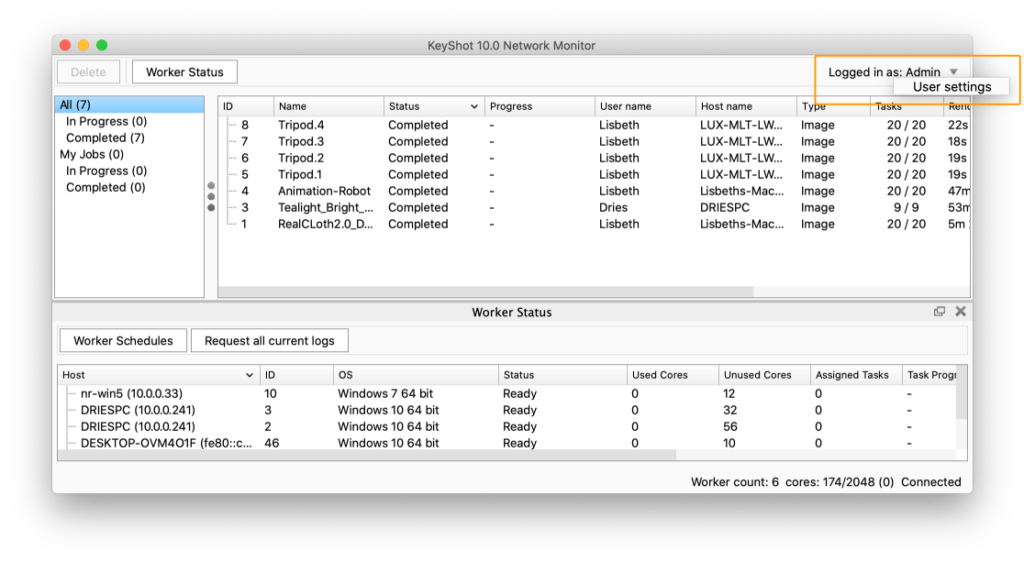

2. Open User Settings
In top right corner of the Render Queue you can now see that you are logged in. Click the triangle next to your username and select User settings.

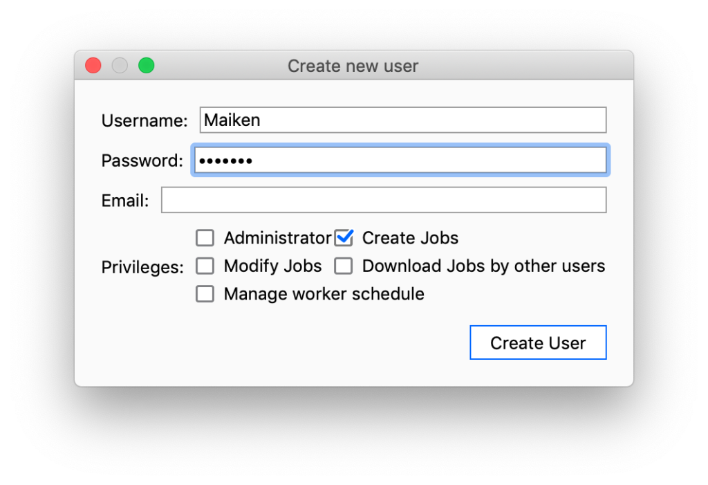

4. Set up new user
When adding an account, fill in the appropriate information, assign privileges, and click Create User. Now the respective user can log in using his/her credentials.
