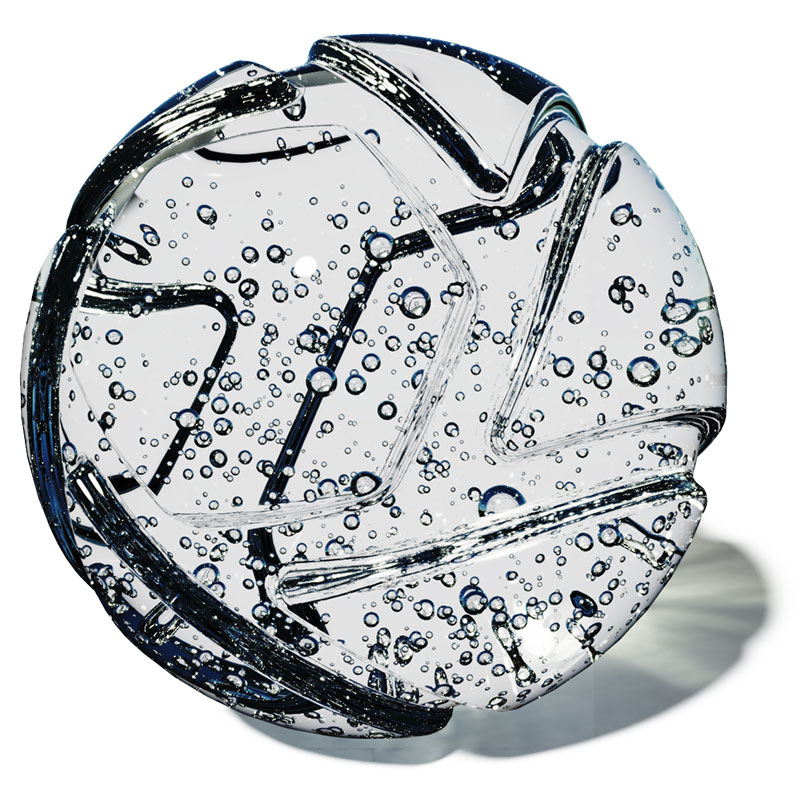

Bubbles
Use the Bubbles node when you want to add spheres of air inside the material of your object. Make sure the material is transparent to some degree, otherwise the bubbles will not be visible. To make the bubbles appear in your geometry, connect the Bubbles node to the Geometry socket of the root Material node.

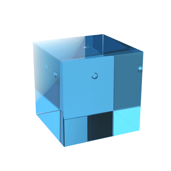

Size
The Size slider sets the size of the bubbles.
The animation shows the effect of varying the bubble size between 0.01 cm and 0.1 cm. The material is Liquid, applied to a 1 cm cube.
Size Variation
The Size Variation slider applies a fractional variation to the bubble size.
The animation shows the effect of varying the bubble size variation between 0.1 and 3.

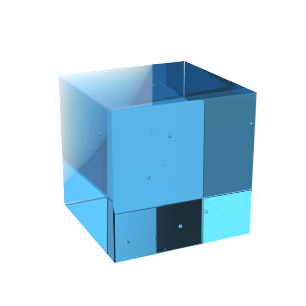

Density
The Density slider will adjust how close the bubbles are to each other.
The animation shows the effect of varying the bubble density between 1/cm and 10/cm.

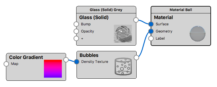

Connected Nodes
Density Texture
If you do not want the bubbles to be distributed evenly inside the object, you can add a texture to control the density. This will act as a mask on the density. Where the texture is black, no bubbles will be shown and the amount of bubbles will increase where the texture is lighter. The density will increase until it (at 100% white in the density texture) reaches the density that has been defined on the bubbles node.
