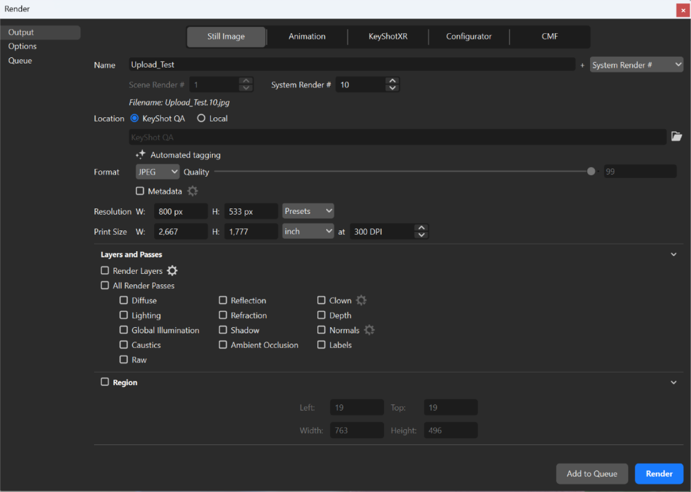

Render Output
By selecting the Hub as your location, your render output will be uploaded after your rendering is done. You can do so by going to Render Dialog > Output > Location and select the radio button [Hub Name].
To specify a specific folder on your Hub, click on the folder icon.
