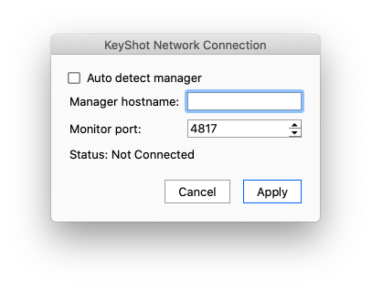

Custom connection
if you need to connect to a specific manager, eg. because you have Multiple Managers on the same network. You simply disable auto-detecting of the Manager and enter a Manager hostname and the correct Monitor port number.
