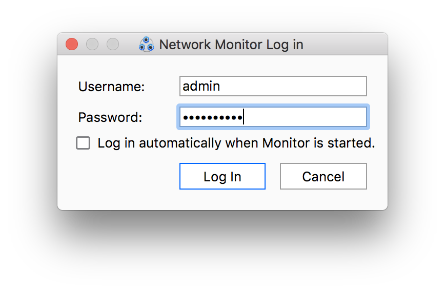

1. Log In
Launch KeyShot Network Monitor, click File > Log in and log in with your administrator credentials.

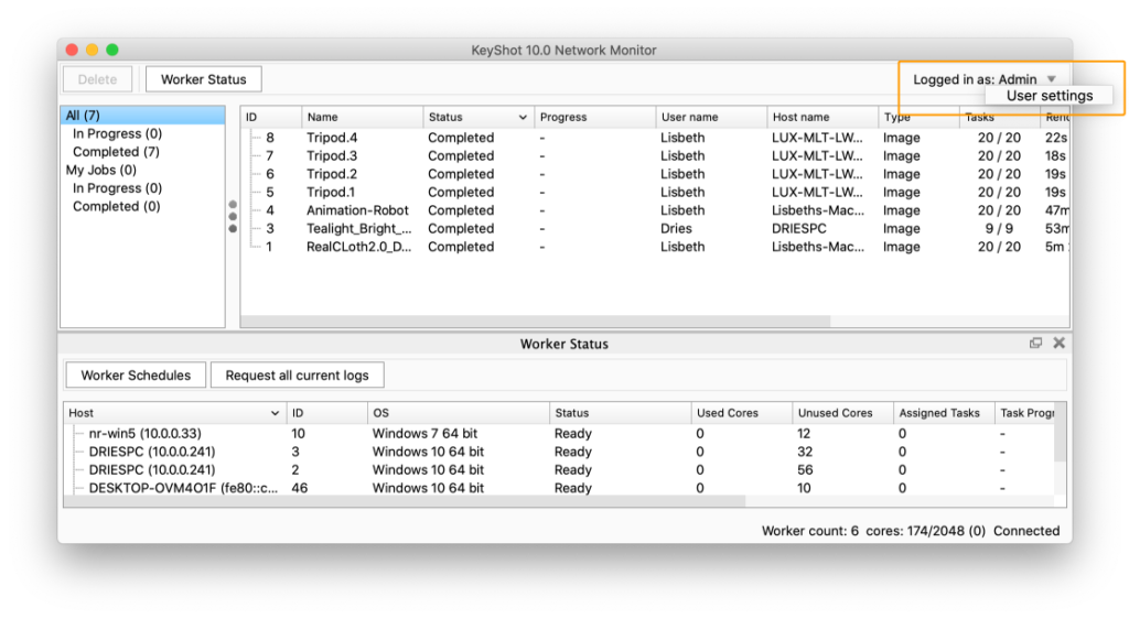

2. Open User Settings
In top right corner of the monitor you can now see that you are logged in. Click the triangle next to your username and select User settings.

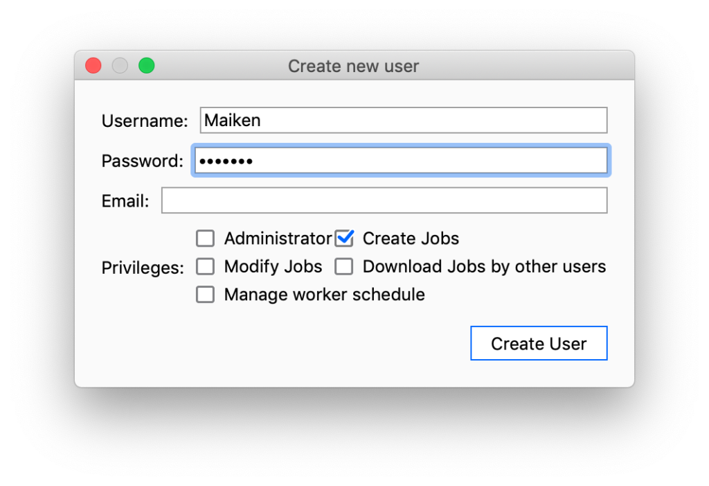

4. Set up new user
When adding an account, fill in the appropriate information, assign privileges, and click Create User. Now the respective user can log in using his/her credentials.

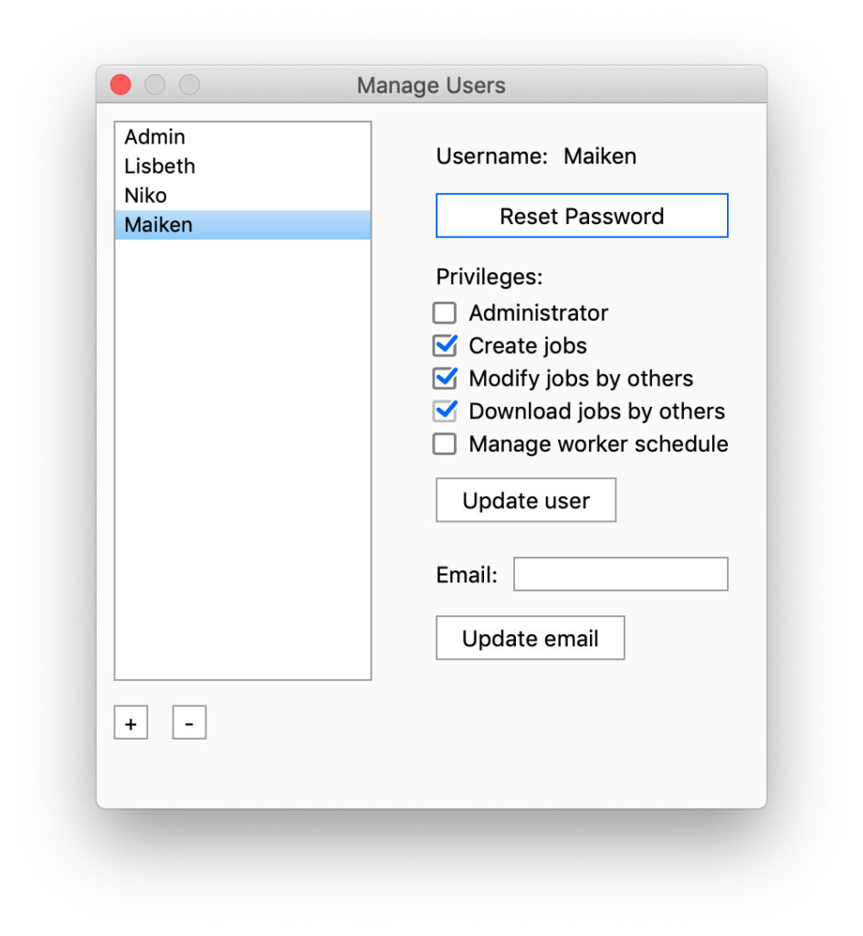

How To Change Account Privileges
1. Select the account and enable/disable privileges.
If the Get Email Notifications are enabled and the email is filed, the user will get a notice when a job is completed.
2.  Click Update User and close the user system dialog when finished.
User Privileges
  • Administrator The user can do all of the things below, as well as add/remove users.
  • Create Jobs The user can send jobs to Network Rendering.
  • Modify jobs by others The user can change priority, pause, and delete jobs by others.
  • Download Jobs by others The user can download all jobs.
  • Manage worker schedule The user can set up/edit Worker Schedules
