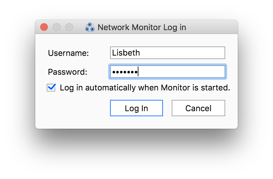

1. Log In
Inside KeyShot Network Monitor, click File > Log in and enter your administrator credentials.

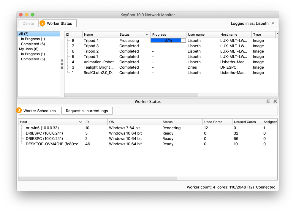

2. Show Worker Status
If the Worker Status panel is not visible Click Worker Status to display it.
3. Launch worker schedule manager
Inside the Worker Status panel, click Worker Schedules.
