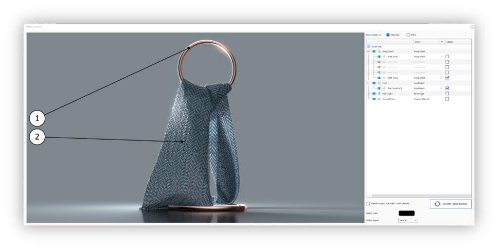

Callout Editor
The Callout Editor enables you to add, edit and manage callouts for your Material Information.
Scene Tree
In the Scene Tree to the right you can choose if you want to base your callouts on materials or on parts, and on which materials/parts you want to have callouts on.
EnableObjects not visible to the camera
This allows you to enable/disable objects in the Scene tree that are not visible to the camera.
Generate Callout Numbers
This will re-generate callout numbers on the materials/parts that have a check mark in the scene tree.
Callout Color
The Callout Color option allows you to customize the color of your callouts.
Callout Layer
The Callout Layer option allows you to choose between a vertical and a horizontal layout.
